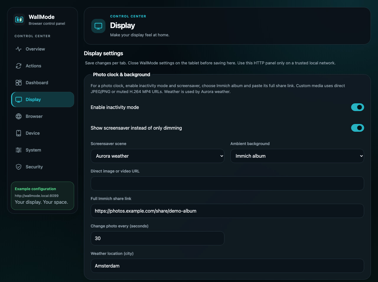

  • Browser-based settings: configure the tablet from a computer or phone on your trusted local network.

The browser control panel, rendered with example settings. No personal dashboard or private album is shown.

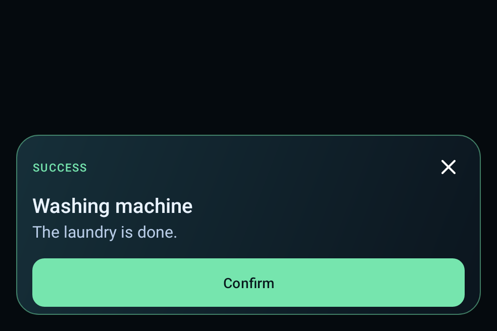

A wall tablet can do more than sit on a dashboard. An automation can show a “laundry finished” notification with a confirmation button, then leave the dashboard available underneath. Temporary views and action prompts can be triggered from Home Assistant too.
Native Android notification example. The title, message and button label are supplied by your automation.
