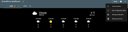

Hi all,
Could you please help me what is the error here?
The config has been managed properly I guess
Thank you in advance!!!

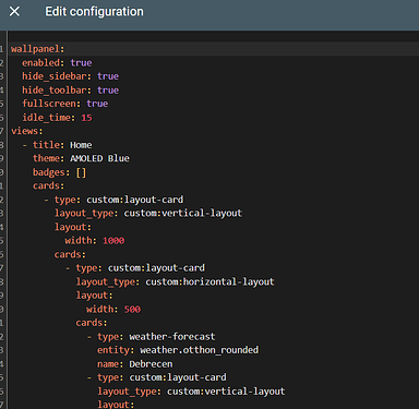

Hi, are you trying to add the panel code in a lovelace card?
I try to create a new dashboard with the hide toolbar and hide sidebar features using this wallpanel addon.
What am I doing wrong…? ![]()
Thanks!
Specifically on how you tried to do it: did you create a card ON an existing dashboard and put the code for the panel in there?
Your question helped a lot! Thank you!
I should add the wallpanel codes at dashboard level using the raw configuration editor.
