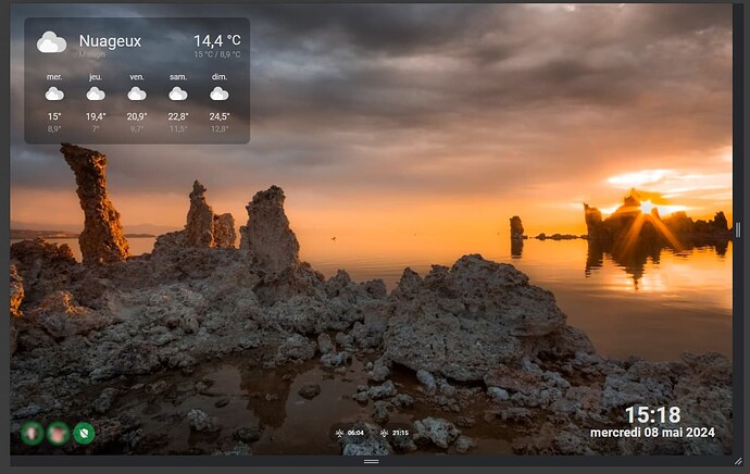

I wanted to share mine, thanks j-a-n for your addon.
The possibilities are immense !
I coupled the wallpaper with the weather and the day/night profile…
An automation changes the profile when the sun rises and sets
image_url: >-
        https://api.unsplash.com/photos/random?client_id={TOKEN}&query=?${entity:weather.maison},${entity:input_select.wallpanel_background},night&sig=${timestamp}
