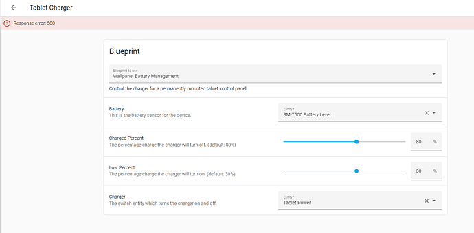

hi I have imported this blueprint but when I setup I get error 500 message:
Perhaps this link can help you trace your issue:
Sounds like it may be an issue in your automations.yaml file

Is that something wrong with importing this blueprint?
I’m getting this error message:
