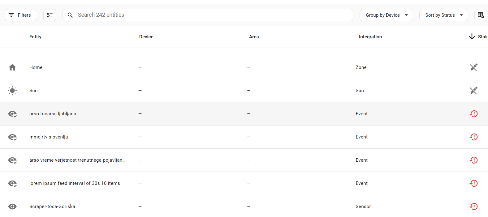

EDIT: did some further investigation. If I check ‘entities’ tab in ‘Devices and services’ I see several entities which used to exist in the past. Obviously at some point I deleted those, but not correctly…
See the photo below:
Anyway, entity who is causing the problem (entity sensor.scraper_toca_lj) is not in this list.
It’s coming from a websocket, are you using node-red?
Not to be aware of. Unless it is used natively by HA (e.g. Traces in Automations).
