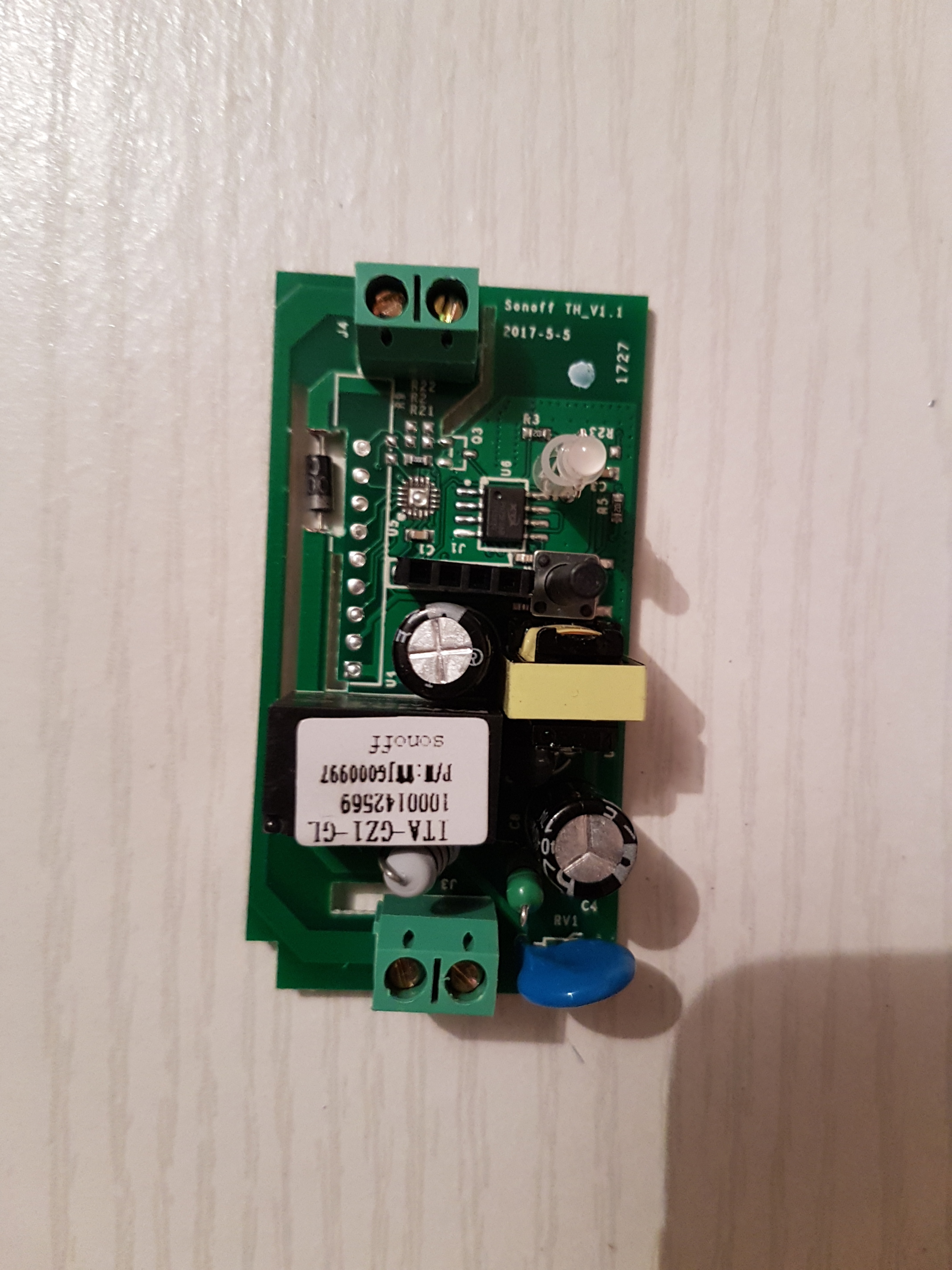

I have bought 10 sonoff to automate heating. I didn’t want to use them to do full on/off because I thought it was dangerous (not enough powerfull), so I have hacked them to play with “fil pilote” (in french) A wire that tell heater to change mode from heat to sleep.
The hack consist of cutting the pcb, and adding a 1n4007 diode (and flashing with tasmota) there are some how to on google.
This is what it look like after modification (check top left) :
I have placed a hacked sonoff behind all my heaters more than one year ago and I had no problem until this day, ha worked automagically with climate module depending on xiaomi sensors in each room and a google agenda planning to define night/away/home mode.
This is the burned sonoff :
I think the electronic heaters use to many amps. The sonoff basic can only handle 10 amps/2200Watts.
That is basically why I have hacked them. I didn’t want all power go through them, but only enough power to give order to this specific wire.
Looks like it burned right by the diode :thinking:

Which also implicitly assumes that the hack failed, and the full current of the heater went through the device?

I really can’t see why replacing the current carrying part of a PCB with a diode is a good idea.
The 1n4007 is typically only rated at 1A, heaters are going to be in excess of 10A.

I guess I’m trying to even understand what the hack was supposed to accomplish?
A diode is just a device that allows current to only flow one direction (a half-wave rectifier). If you put it in the middle of the power line you have just made the load run on DC power instead of AC power. And the diode is only a passive device. It has no control inputs at all.
How does making the heater a DC load help decide how to put the heater to sleep or not?
And looking at the specs for the diode it is only rated for 1A so I’m not surprised that it burned up.
The diode feeds a sensor line not the load.
yeah, that’s what it says but looking at the cables connected to that thing it looks like it’s expected to carry more than 1A.
I’d be interested to see what the load was that was on the output terminals and how it was connected.
