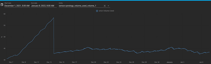

I guess another downside is that I didn’t even notice the memory creeping up when I was running a alpha build of HA in the beginning of December
