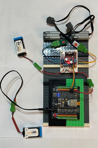

When my script was installed on the ESP32-Wroom-32E, I could manage 4 DC motors (with 2 L298Ns), 2 LEDs, 1 buzzer, 2 ultrasonic sensors to measure the distance of a toy car I had built for my grandson with Lego…
Everything worked fine.
When I changed the microcontroller (ESP32-S3-Wroom-1), I migrated the YAML script (adapting the GPIOs to the new board) and installed it. At this point:
  • I got the warning message “[W][ledc.output:109]: The LEDC output has not yet been initialized!” repeated every second
  • the microcontroller is very slow: the buzzer, LEDs, integrated circuits, etc. are not working or are extremely slow. No motors are running properly, even at idle.
I suspect something related to the frequency of the GPIOs to set (and count speed parameter). But I do not know determine the frequency value (I am not electronical this doesn’t ring in my ears)
The motors are Lego Power Functions M motors, I would have 5 levels of speed (0%, 25%, 50%, 75% and 100%)
Neither mine.
I wonder how all this is powered. Hopefully not from Esp32.
What you get on your Esphome log while it’s running “slow”? I mean runtime log.
The motors are powered by 9V external baterries.
For one L298N (2 motors) I have the following wiring:
  • pin 12v ← terminal + of the 9V external battery (DC power Source)
  • pin gnd ← terminal - of the 9V external battery (DC power Source)
  • pin gnd ← GND of the ESP
  • pin 5V ← 5V of the ESP
  • IN1 ← GPIO pin a of motor 1
  • IN2 ← GPIO pin b of motor 1
  • IN3 ← GPIO pin a of motor 2
  • IN4 ← GPIO pin b of motor 2
  • OUT1 → wire C1 of motor 1
  • OUT2 → wire C2 of motor 1
  • OUT3 → wire C1 of motor 2
  • OUT4 → wire C2 of motor 2
The Ground of the battery and of the ESP are connected together
Jumpers ENA & ENA are installed
The 5V Jumper is installed

That’s not runtime log.
Jumper on place or removed (L298)?
The last lines of the report is the “runtime log” (I suppose this - if not, where I can find it?)
The 5V jumper is on place
So you are powering Esp from battery through L298N?
here is the log I have downloaded with the “Log” button:

So the jumper IS “removed” (on side). And Esp is powering L298. OK.
I don’t see that 6LR61 battery is reliable power source for Esp especially if Esp powers other components. It’s not capable of sourcing lot of current, even less if it’s not in full charge.
I’m not saying that is your problem here though.
Did you find the runtime logs?
During my tests I use a AC/DC converter and I see the same issue (the warning message):
I have posted the results above
This is confusing.
You wrote the board is working, but extremely slow.
So what the log prints when the board is working?
