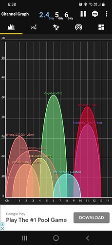

There are several Wi-fi analyser phone apps which are great to help you see what is going on.
Note however that these show you the signal strength (mostly how close the access point is) rather than how busy that channel is.
