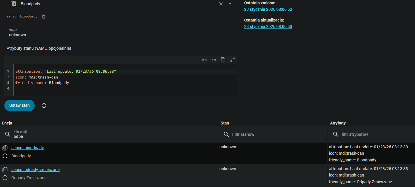

I’ve been struggling with this add-on for several days now and I’m giving up. Please help, my sensors are constantly showing unknown status. Everything looks fine, all the files are in place. The data is correct, the addresses and so on, but the sensors are still down.

Does the waste collection integration work in general, i.e. do you see the dates in the calendar?
Just to make sure there is no problem with the source of the data (in my case waste collection schedule is not working, which is a known issue for my location).
I seem to have the same problem. Even the bookmarks for rubbish collection were added automatically, but unfortunately the calendar is empty.
If the calendar does not show any waste collection dates, there might be problems with the WCS datasource. In this case, check the issues list on github if the problem for your specific location is already known.
