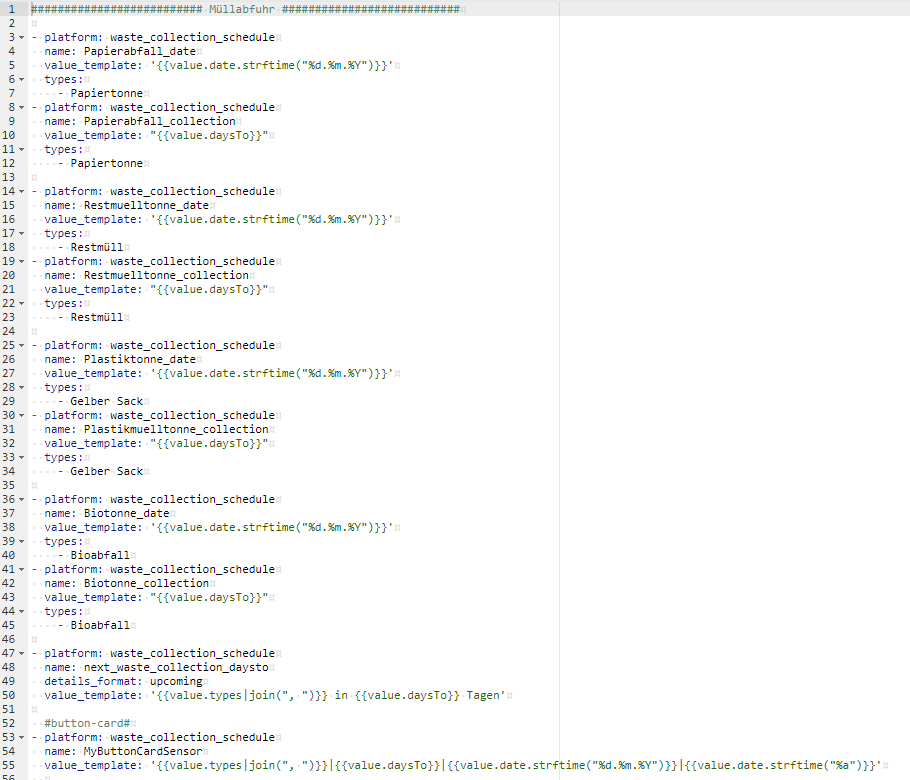

I don’t know why, but from one day to the next, it no longer works for me.
As far as I can see, the code in the card, the ICS file and the sensors.yaml are correct. Where would I have to start to fix this?
EddieFAF
(Mathias)
October 10, 2023, 10:31am
388
Can you show the content of the ICS file? You posted the sensors twice
