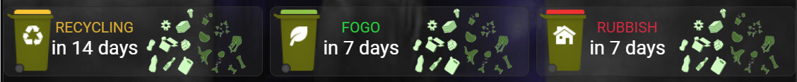

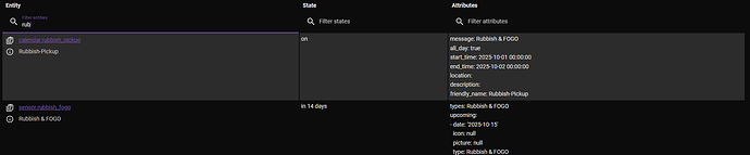

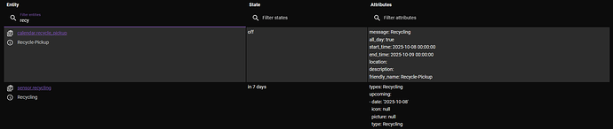

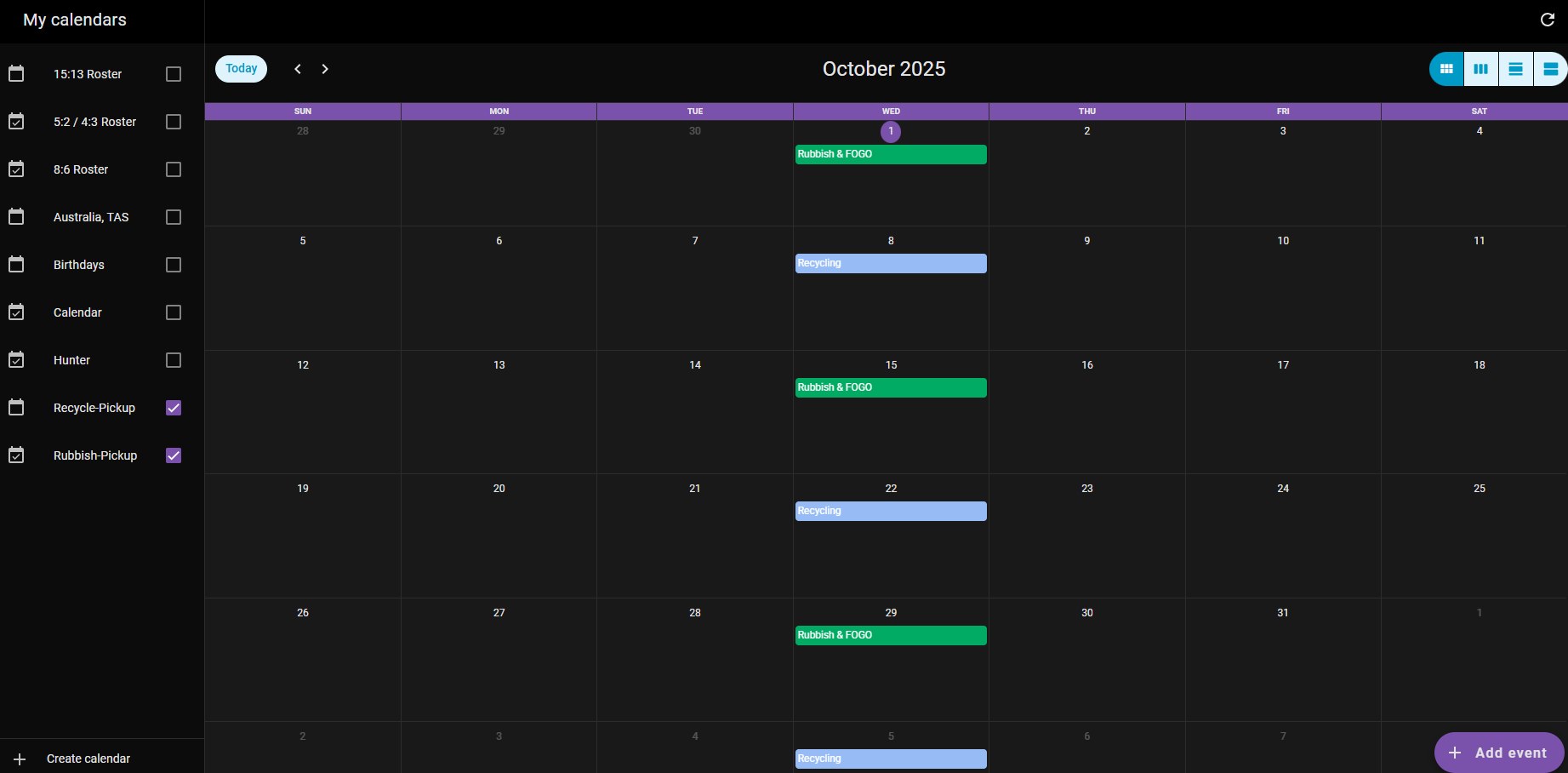

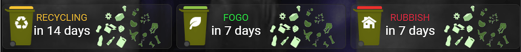

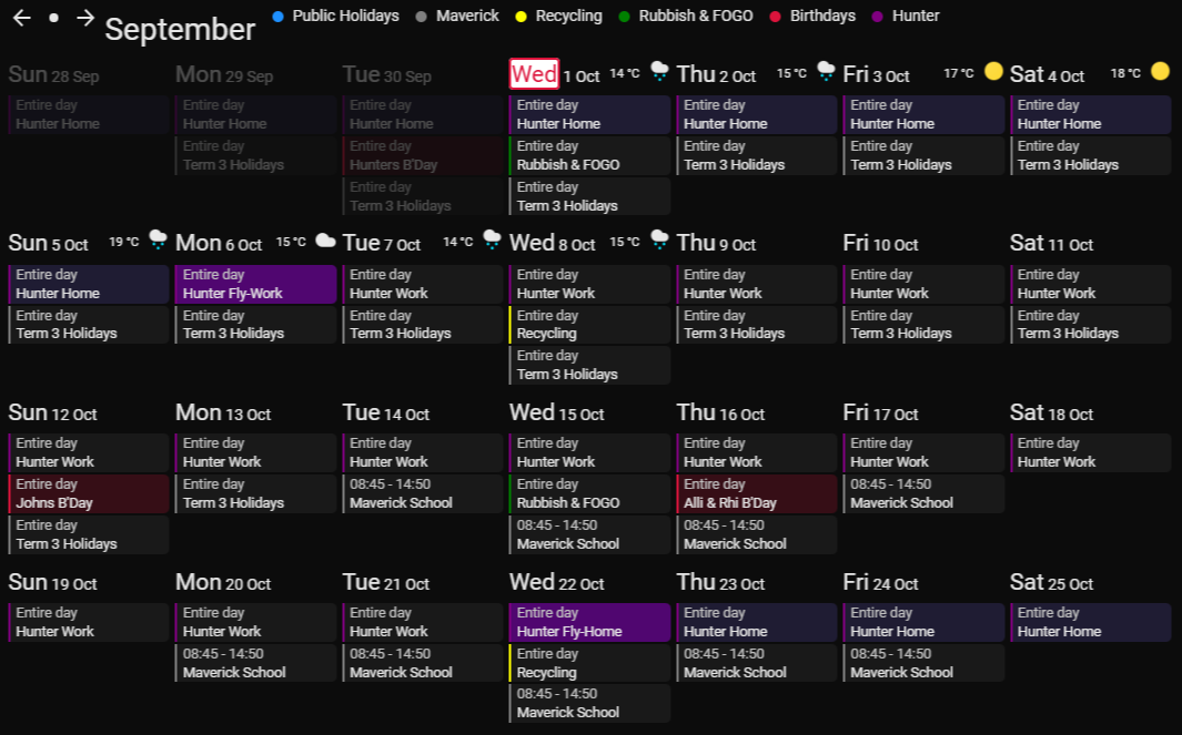

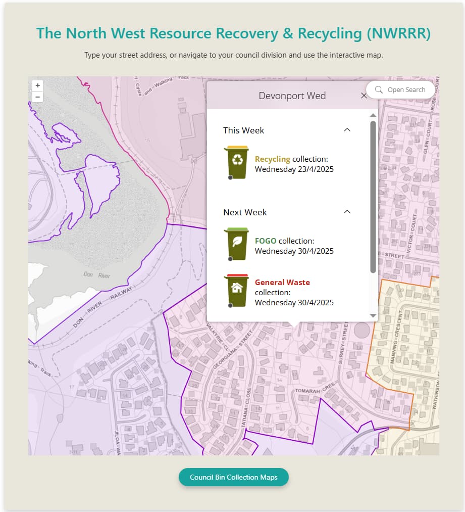

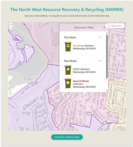

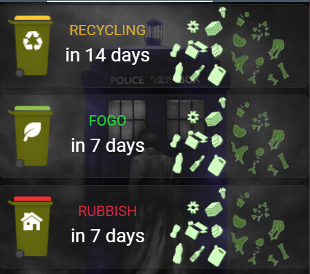

I want to add a new service provider for garbage collection schedule but can’t seem to find ical or the information required to create dedicated source?
My current manual configuration only populates the calendar 6 months in advanced and I have to keep reloading the source with a new start date to update my calendar
The website is a map style Collection Day Calendar — North West Resource Recovery and Recycling.
I have currently configured a manual source
# Waste Collection Schedule
waste_collection_schedule:
  sources:
    - name: static
      calendar_title: Rubbish-Pickup
      args:
        type: Rubbish & FOGO
        frequency: WEEKLY
        interval: 2
        start: "2025-04-30"
        weekdays: WE
    - name: static
      calendar_title: Recycle-Pickup
      args:
        type: Recycling
        frequency: WEEKLY
        interval: 2
        start: "2025-04-23"
        weekdays: WE
  day_switch_time: "12:00"

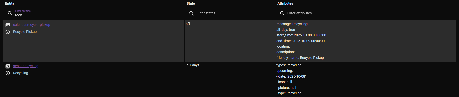

…and manual sensors
      - Rubbish & FOGO
  # Sensor next recycling collection
  - platform: waste_collection_schedule
    source_index: 1
    details_format: "generic"
    add_days_to: true
    value_template: "{% if value.daysTo == 0 %}Today{% elif value.daysTo == 1 %}Tomorrow{% else %}in {{value.daysTo}} days{% endif %}"
    types:
      - Recycling
  # InfluxDB Rain Sensor
  - platform: influxdb
    host: a0d7b954-influxdb
    port: 8086
    username: "homeassistant"
    password: "homeassistant"
    queries:
      - name: rain influxdb
        unique_id: f0f6141d-97bd-4fb6-8b15-d18a45fd0b7c
        unit_of_measurement: mm
        value_template: "{{ value | round(2) }}"
        group_function: last
        where: '"entity_id" = ''netatmo_devonport_tas_indoor_rain_rain_today'''
        measurement: '"mm"'
        field: value
        database: homeassistant
Thought I would share

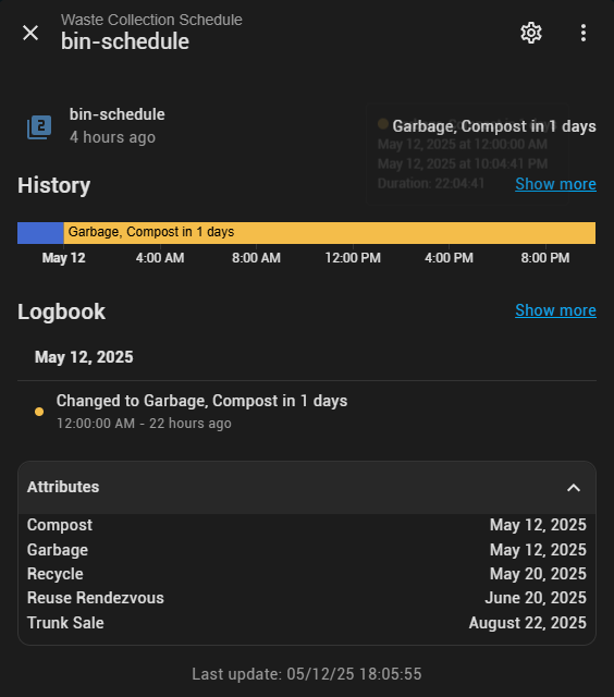

Hey everyone, I’ve struggling with getting this to work and kinda at my wits end with AI. I want to get a notification every hour until I dismiss the notification, I get it to check the date and start sending the notification 6 hours the day before the bin schedule. Theres a bin schedule for compost+garbage, and compost+recycling. The later works as expected, but not the former (compost+garbage)
alias: Waste Collection Notifications v2 - BETA
description: Unified automation for waste collection notifications and action handling
triggers:
  - hours: /1
    trigger: time_pattern
  - event_type: mobile_app_notification_action
    trigger: event
actions:
  - data:
      message: >-
        Automation triggered by: {{ trigger.platform }}, event data: {{
        trigger.event.data if trigger.event is defined else 'No event data' }}
      level: info
    alias: Log trigger details for debugging
    action: system_log.write
  - choose:
      - conditions:
          - condition: trigger
            id:
              - button
        sequence:
          - data:
              message: Bins marked as ready
              level: info
          - target:
              entity_id: input_boolean.garbage_compost_done
            action: input_boolean.turn_on
            data: {}
          - target:
              entity_id: input_boolean.recycle_compost_done
            data: {}
          - data:
              message: ✅ Bins have been taken out 🎉
                tag: waste_completion
                color: "#00CC00"
                channel: Waste Collection
                importance: high
            action: notify.mobile_app_jmurphone_15
          - action: script.turn_on
            metadata: {}
            data: {}
              entity_id: script.reset_inovelli_leds
    default:
      - data:
          message: Running hourly check for waste collections
          level: info
      - variables:
          garbage_date: "{{ state_attr('sensor.bin_schedule', 'Garbage') }}"
          compost_date: "{{ state_attr('sensor.bin_schedule', 'Compost') }}"
          recycle_date: "{{ state_attr('sensor.bin_schedule', 'Recycle') }}"
          garbage_hours: |-
            {% if garbage_date %}
              {{ ((as_timestamp(strptime(garbage_date, '%Y-%m-%d')) - as_timestamp(now())) / 3600) | round(2) }}
            {% else %}
              {{ 999 }}
            {% endif %}
          compost_hours: |-
            {% if compost_date %}
              {{ ((as_timestamp(strptime(compost_date, '%Y-%m-%d')) - as_timestamp(now())) / 3600) | round(2) }}
            {% else %}
              {{ 999 }}
            {% endif %}
          recycle_hours: |-
            {% if recycle_date %}
              {{ ((as_timestamp(strptime(recycle_date, '%Y-%m-%d')) - as_timestamp(now())) / 3600) | round(2) }}
            {% else %}
              {{ 999 }}
            {% endif %}
      - if:
          - condition: and
            conditions:
              - condition: template
                value_template: |-
                  {{ garbage_hours > 0 and garbage_hours <= 6 and
                     compost_hours > 0 and compost_hours <= 6 }}
              - condition: state
                state: "off"
        then:
          - data:
              title: Waste Collection Alert
              message: >-
                🗑️🍃 Garbage and Compost collection in {{ [garbage_hours,
                compost_hours] | min | round }} hours! Please prepare your bins.
            enabled: false
            action: notify.notify
          - data:
              message: 🗑️🍃 Garbage and Compost Day Tomorrow - Prepare Bins
                tag: waste_garbage_compost
                color: "#FF6600"
                importance: high
                actions:
                  - action: MARK_AS_DONE
                    title: Bins Are Ready
                    icon: mdi:check
          - action: notify.mobile_app_iphone
                color: "#FF6600"
                importance: high
                actions:
                    icon: mdi:check
          - target:
              entity_id: script.garbage_notify
            data: {}
        alias: Check for Garbage and Compost Day
      - alias: Check for Recycling and Compost Day
        if:
          - condition: and
            conditions:
                value_template: |-
                  {{ compost_hours > 0 and compost_hours <= 6 and
                     recycle_hours > 0 and recycle_hours <= 6 }}
              - condition: state
                state: "off"
        then:
          - data:
              message: >-
                ♻️🍃 Recycling and Compost collection in {{ [compost_hours,
                recycle_hours] | min | round }} hours! Please prepare your bins.
            enabled: false
          - data:
              message: ♻️🍃 Recycling and Compost Day Tomorrow - Prepare Bins
                tag: waste_recycle_compost
                color: "#009966"
                importance: high
                actions:
                    icon: mdi:check
          - action: notify.mobile_apps_iphone
                color: "#009966"
                importance: high
                actions:
                    icon: mdi:check
          - target:
              entity_id: script.recycle_notify
            data: {}
      - if:
            value_template: "{{ garbage_hours < 0 or compost_hours < 0 }}"
        then:
          - target:
            action: input_boolean.turn_off
            data: {}
      - if:
            value_template: "{{ recycle_hours < 0 or compost_hours < 0 }}"
        then:
          - target:
            data: {}

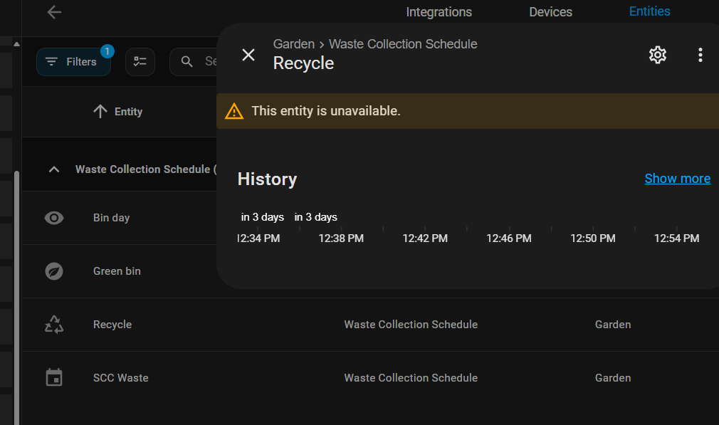

Hi, I’ve installed this integration from HACS. I’ve got sensors/entities with information but they are listed as ‘unavailable’ which means I can’t use the sensors when adding cards.
Well there you go. It just started working!!!

  1. Restart HA, NOTE: The Waste Collection Schedule will not show up in your Integrations Page.
  2. Check Developer Tools Sensors
  3. Check the Calendar in the side bar your calendar entities will be there now
  4. Now you can use the calendar entities for dashboards
  5. You can use the sensors to use in Garbage Collection Cards.
