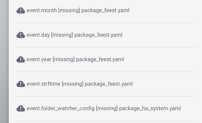

getting false alarms now on templates with this:
          {% set event = vj_marijn %}
          {% set year = 1 if event.month < now().month or
                            (event.month == now().month and event.day < now().day)
                         else 0 %}
Watchman reporting
the latter event is used in
  - id: folder_watcher_config
    mode: queued
    max_exceeded: silent
    triggers:
      - trigger: state
        entity_id: event.folder_watcher_config
        attribute: event_type
        to:
          - created
          - deleted
so seems an oddity too? this one is an actual event, the others are variable names … (I could probably fix that using non reserved word there…)
update
And yes, after renaming the variable names to non reserved words, those disappear from the report;
the folder watcher remains though (it really shouldnt) and the backup mentions are regulars, the integration seems to take a while before those entities are created, I guess I could whitelist those 2. Especially since they’re on the same page as the card for the Backup integration itself :wink:
btw see those state there? they’re also made by that integration ands not correctly translated by the frontend somehow… device_class playing up there
Right, it seems very similar to date.* issue.
Update: Since events do not have persistent states besides unknown, they should be removed from the watching list. This will be addressed in a future fix. Not sure about date.* yet.
Sorry for the inconvenience.
thx, I did add the info to that issue.
Should I write it up separately?
No, I’ve published a beta 0.7.0 to HACS which should resolve issues with date and event entities.

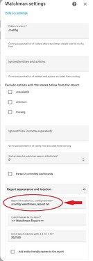

Trying to run watchman.report, I get an error:
Logger: homeassistant.components.websocket_api.http.connection
Source: components/websocket_api/connection.py:315
integration: Home Assistant WebSocket API (documentation, issues)
First occurred: 07:54:12 (1 occurrences)
Last logged: 07:54:12
[139757406392608] Error handling message: Unable to write report: [Errno 2] No such file or directory: ā€˜ā€™ (home_assistant_error) Jxxxxx Lxxxxx from (IP address) (Mozilla/5.0 (Linux; Android 14; OPD2203 Build/UKQ1.230924.001; wv) AppleWebKit/537.36 (KHTML, like Gecko) Version/4.0 Chrome/130.0.6723.107 Safari/537.36 Home Assistant/2024.10.3-14058 (Android 14; OPD2203))
The one thing I see is that the Redacted (IP address) is incorrect.
I am getting the same error on 2025.1, however the persistent notification works. There is no report file been written to the file system.
Happened to me too. You need to specify a path for the report to be generated using the Watchman configuration.
HA → Settings → Devices & services → Watchman → Configure
