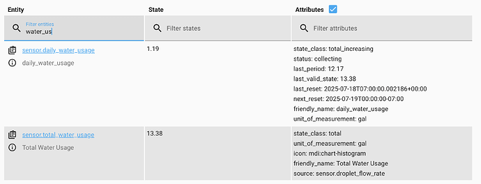

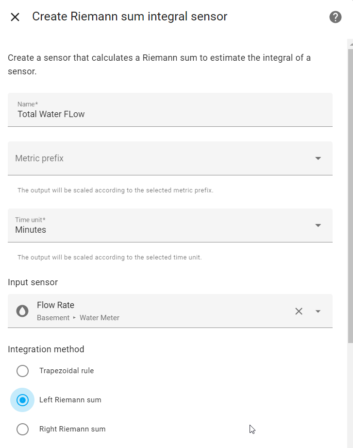

Change your integral time unit to minutes instead of hours, which I believe is the default.
Also, you’re probably going to want left sum instead of the default trapezoidal. Frequent threads related to this issue.
Thank you sir. Will try that shortly. Appreciate the help.
Worked perfectly.
Thank you again.

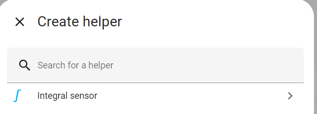

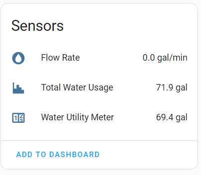

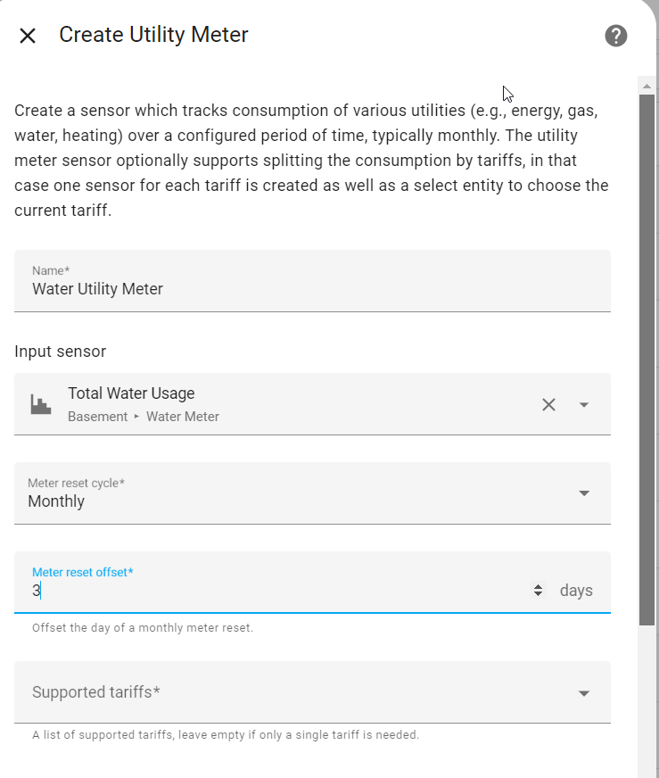

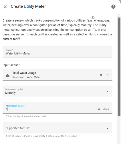

For others that find this and are adverse to YAML like me, here’s how I did it.
  1. Create helper to convert/sum the Droplet flow in gal/min to gallons. Use the Integral Sensor option. Set time unit to minutes and choose Left Riemann sum option
  1. Create Utility Meter Helper. Choose the integral sensor from step 1 as the input sensor. I have it reset on the same day as my water bill.
You should now have 3 entities under your Droplet device

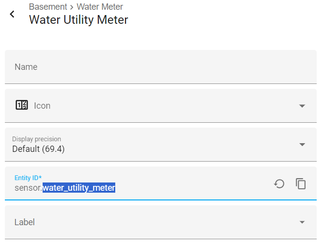

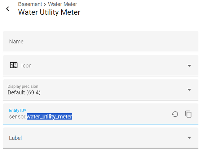

  1. now a tiny bit of YAML is needed. Use the file editor add-on to find your configuration.yaml file. Add this tiny bit of code. Make sure the sensor.XYZ part matches the entity ID for the water utility created in step 2.
homeassistant:
    customize:
        sensor.water_utility_meter:
            device_class: "water"
  1. restart Home Assistant and edit the energy dashboard
