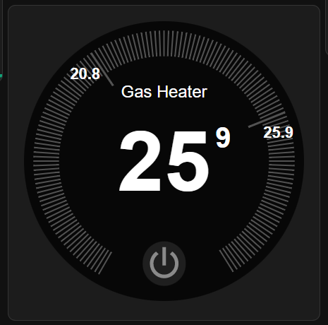

I have a GAS heater in the Lounge which only has an IR control
here is the GAS heater turn on/off
  - platform: broadlink
    mac: 'Bla:Bla:Bla'
    switches:
      - name: "Gas Heater"
        command_on: 'blabla'
        command_off: 'BlaBla'
- platform: generic_thermostat
  heater: switch.gas_heater
  target_sensor: sensor.bt_lounge_temperature
  min_temp: 15
  max_temp: 30
  ac_mode: False
  target_temp: 20.8
  initial_hvac_mode: "off"
  cold_tolerance: 0.2
  hot_tolerance: 0.2
  away_temp: 16
it only comes on when
TV is on and the lounge lights are on that’s my logic to say someone is in the lounge
its card
type: custom:thermostat-card
entity: climate.gas_heater
title: Gas Heater
I’ve done not much, quite stuck on start…
