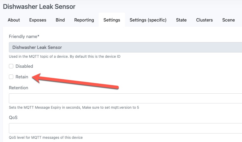

You might try setting “Retain” on one of those devices to see if that keeps it from triggering. In my situation, my automation only triggers if “moist” so I don’t have that situation, but I can see how moving from “unknown” to “Dry” can trigger your automation. I think setting “Retain” will keep the previous known value and potentially keep your automation from triggering upon startup.
Hi @lymkin
unfortunately It dows not work. I set retain on zigbee2MQTT but on HA restart, Dry was triggered.
Thanks
