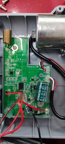

Are you able to open it up enough to see if it has an ESP8266 in it?
Hi Marc! @mrand
I’ll see if i can open the cover over the weekend, although, i have 0 experience with flashing and soldering. But if it can work, i’m open to trying.
Thanks! Will update after I open it up

Will post a picture of the Tuya flow meter once I open it up. Maybe you can guide me through the process if there is an ESP inside.

Sorry, I missed your reply on this. Nice of them to mark RX, TX, and GND. What does the other side of the PCB have on it?
