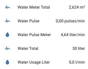

I just configured a water-meter with an ESP8266 and combined a few info gathered in the documentation and the forums.
I want my water meter in HA to show the total (in m3) I read on the physical water meter.

So:
  1. My current total is in phase with the physical reading
  2. I made sure water was used and usage detected in HA
  3. I waited (much) more than 5 minutes to be on the safe side
  4. I reboot the device
  5. Total is reset to 0
Somehow I miss something but don’t know what.
