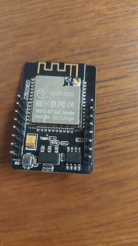

This is the ESP32 cam that used to various tests, removed from a camera just for tests.
