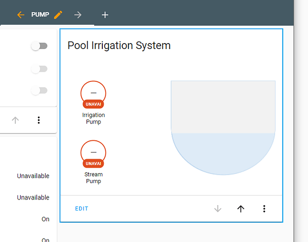

Didn’t get any responses here but i think i was able to pull off what i wanted with the Picture Elements card. For future google searchers here is how i accomplished a single card that shows different pictures that represent different water levels in a tank. In my hardware setup i have 4 level switches. One note - had to add space in the images so the background image didn’t take up the entire card as is the default.
Associated YAML for the card…
