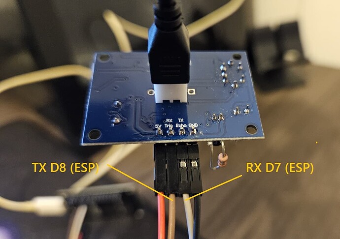

Here is the board with the 47k resistor:
as you can see the RX (and TX on the ESP) pin is disconnected at the moment because not needed in Mode 1
Here the test for mode 2, with a 120k resistor (100k+22k):
and the updated YAML:

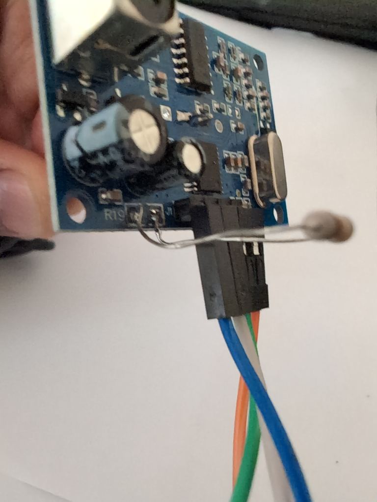

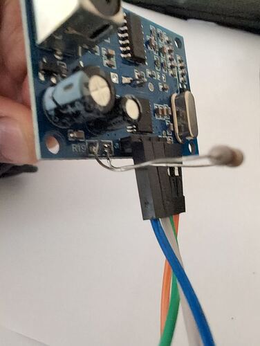

btw, I put 120k resistor on the points of the sensor - see picture.
The led on the sensor and the board are flashing in tandem, so they are talking to each other - which in and of itself is a breakthrough after 2 days…
Ok! I found the solution in this post: Ultrasonic aj-sr04m not working - #8 by Zarka44
