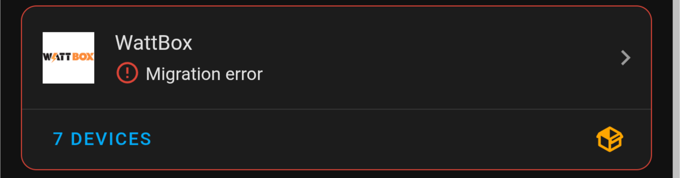

I haven’t tried to add the 700 series yet but upon first reboot after installing the beta I received this error and the 800 didn’t load
Logger: homeassistant.config_entries
Source: config_entries.py:1069
First occurred: 12:07:16 AM (1 occurrence)
Last logged: 12:07:16 AM
Flow handler not found for entry WattBox WB-800-IPVM-6 for wattbox
This is what it shows in the devices page
And I can’t add another device
I also noticed the device page says it’s v1. 0.0 but in HACS it does say it’s on beta1, I even redownloaded it and restarted one more time but it’s still not working.

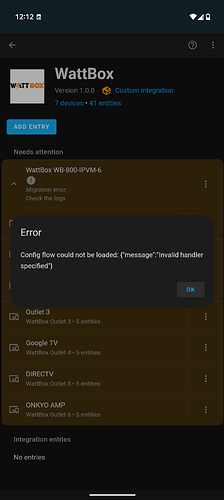

I deleted it and restarted but it won’t let me add anymore.
The error is the same when I tried to add the 700 while the 800 was still in devices.
Config flow could not be loaded: {"message":"Invalid handler specified"}
