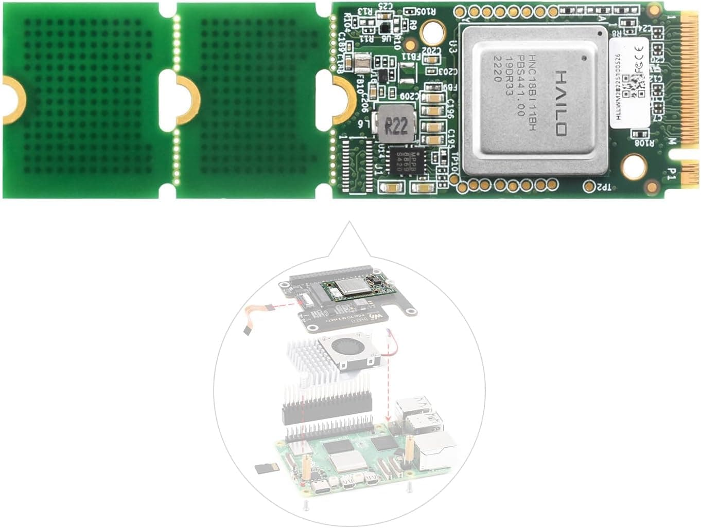

Waveshare Hailo-8 M.2 AI Accelerator Module for Raspberry Pi 5 compatibility with HAOS and the Home Assistant Yellow hardware?
Will the Waveshare Hailo-8 M.2 AI Accelerator Module for Raspberry Pi 5 compatibility with Home Assistant Operating System and the Home Assistant Yellow hardware out-of-the-box? And even if it will work is there a risk it will get too warm/hot inside the Yellow case?
For reference, that in turn is Waveshare variant of reference Hailo-8 M.2 AI Accelerator which you can find in Raspberry Pi PCIe Database:
Backstory is that it was previously announced that the Home Assistant Operating System 14 brought support for the Hailo-8 AI accelerator, and at that time the only option available on the market was the M.2 AI accelerator card found in the Raspberry Pi AI Kit, but that only features the low-end “Hailo-8L” chip with just 13 TOPS computing power variant in the Hailo-8 AI accelerator chip series, which is a lot less compared to the faster Hailo-8 AI accelerator chip used in the Raspberry Pi AI HAT+ which gives at up to 26 TOPS compute power, but now Waveshare have released their Waveshare Hailo-8 M.2 AI Accelerator Module with the same chip which at least looks to have the correct form-factor, though the question is if it in practice will work with the Home Assistant Yellow enclosure and the latest HAOS?
The specification sais Power consumption is typically 2.5W but that it can draw up to 8.65W (Max).

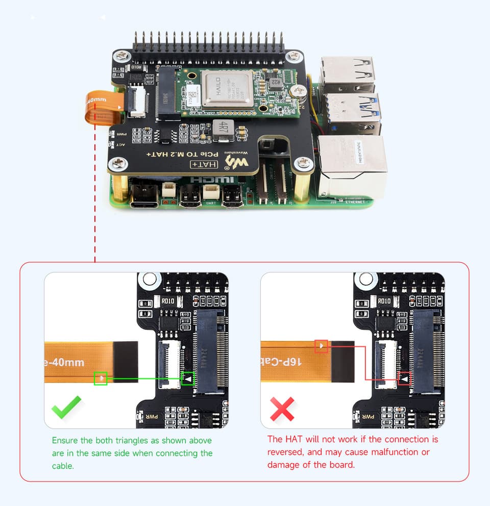

If you have a normal Raspberry 5 then they also have Waveshare PCIE M.2 HAT+
Waveshare wiki looks to indicate that it uses the same PCI identifiers as the AI KIT+ (1e60:2864), and the guide doesn’t mention any specific driver needed on RPi OS. It calls for dtparam=pciex1_gen=3 though I read a report of someone running the Raspberry Pi AI Kit without that (see cross-post).

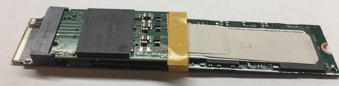

I have at least not seen anyone else who sells exactly such an “Single slot to dual M.2 adapter” adapter but found this “NVME to dual SSD adapter” which does not have the same functionality since it is only converts one NVMe slot to two SATA module slots but think it might still be good as a visual reference of a stacked form-factor concept:
If you look at the pictures of those bellow then I think you will at least get an idea of the form-factor the concept where you would instead have new dual adapter that allows the user to add NVMe SSD underneath in the stack and the AI accelerator stacked on top of it via the dual M.2 slots that would need to be stacked with an off-set for that.
