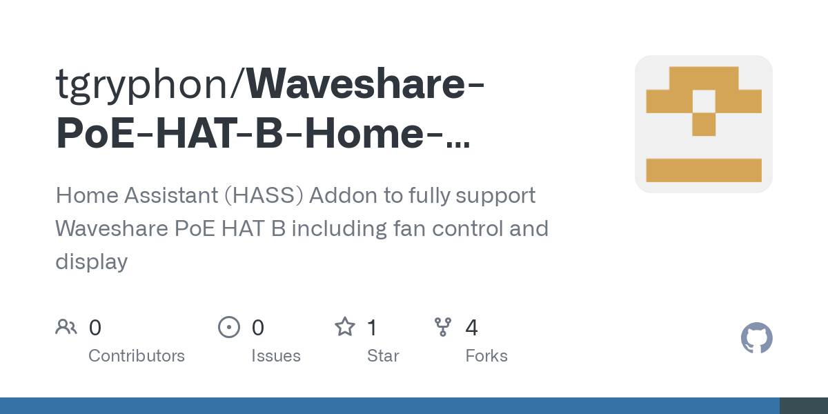

For anyone with this issue, the same issue was reported on the GitHub repo with this add-on. Someone has forked the code and fixed the issue, probably.
I got the same error with the original repo/add-on, this fork started up fine. I have a different Waveshare Fan Hat without PoE and the code blew up but at least I can fork the fork and know I’m working from a good starting point. If you have this exact Hat then maybe this repo will work for you.
