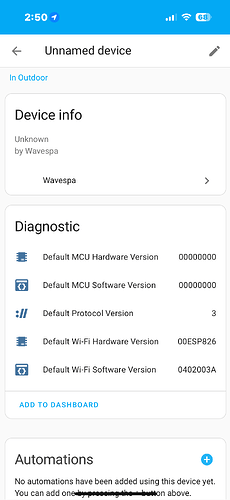

I tried installing this, but I am only getting Disgnostic data and no controls or temp info. Any help or insight or something that I missed?
Hi, which WaveSpa do you have? I’ve only tested on my Garda
I notice from your screen shot its missing Wave_SPA_EU which is set as the product name if it matches. So my guess is either your device has a different product code or is a non EU version?
