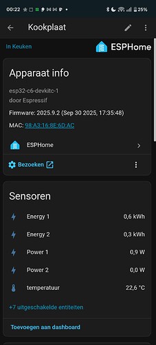

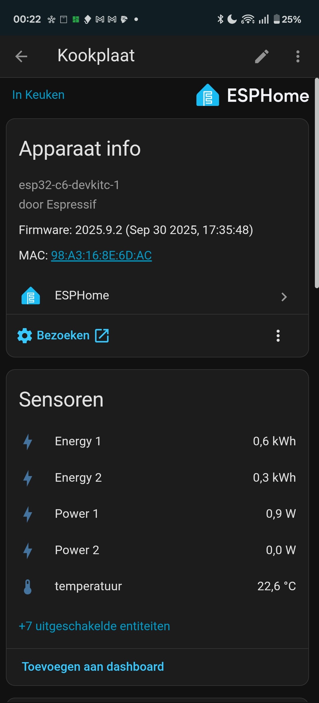

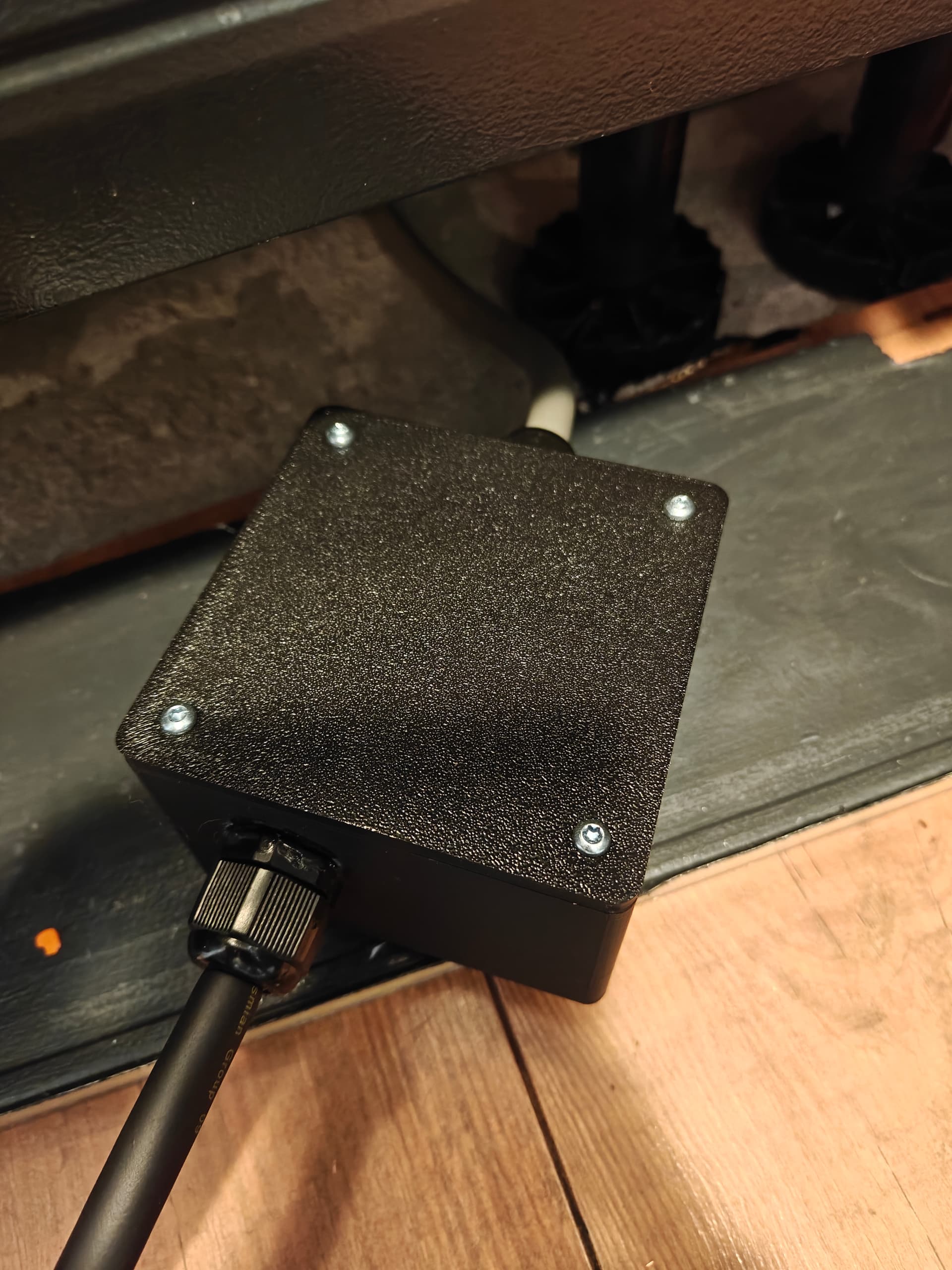

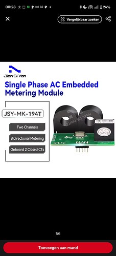

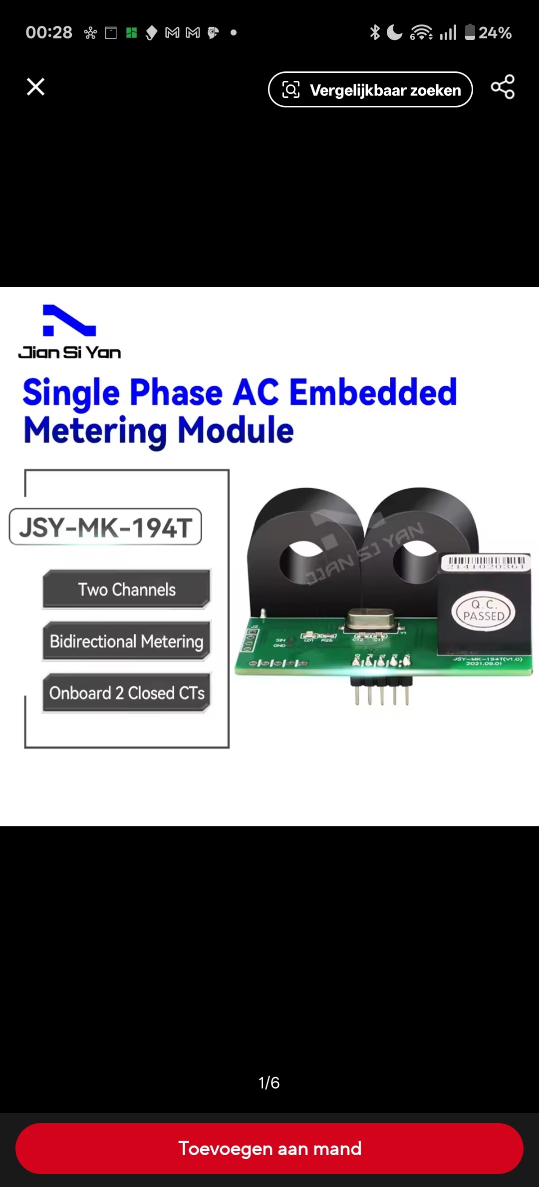

Bom:
Esp device.
Jsy MK 194T.
https://a.aliexpress.com/_EQ0KZZU
3d print a box.
2x M20 cable throughputs.
perilex cable connector with a meter off cable.
5 wago connectors.
1x a 5v hylink power supply.
The cooking plate here is connected with 2 fases.
Result:
The 0.9 Watt is the 5V power supply and the standby power draw when cooking plate is idle.
The temperature sensor is added to monitor the temperature of the box. The cooking plate is hardwired to the measuring box with the wago connectors.
Used a different 5V power supply that i had but a Hylink is more convenient.
