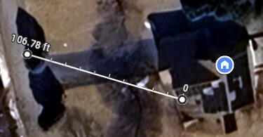

I have a very robust Zigbee mesh with 160+ devices, including 25+ repeating devices (of various types). I have a single family house with standard construction for New England/USA: wood 2x4 framing with wood clapboard siding.
I have a Zigbee contact sensor (Visonic MCT-370) in my metal mailbox, which is routing to a Zigbee outlet (repeater) contained inside my house about 100 feet away. That repeater is plugged into an outlet on the inside of the exterior wall.
Basically, I had to do nothing special to get the Zigbee signal out to the mailbox.
