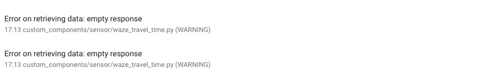

@petro I am using the code you posted, I am not getting startup errors either, but am still getting
2019-03-10 11:36:06 WARNING (SyncWorker_11) [custom_components.waze_travel_time.sensor] Error on retrieving data: empty response
2019-03-10 11:36:06 WARNING (SyncWorker_18) [custom_components.waze_travel_time.sensor] Error on retrieving data: empty response
2019-03-10 11:36:06 WARNING (SyncWorker_16) [custom_components.waze_travel_time.sensor] Error on retrieving data: empty response
2019-03-10 11:36:06 WARNING (SyncWorker_10) [custom_components.waze_travel_time.sensor] Error on retrieving data: empty response
2019-03-10 11:36:06 WARNING (SyncWorker_15) [custom_components.waze_travel_time.sensor] Error on retrieving data: empty response
about every 10 minutes so far. I have 5 sensors all of which use a device tracker for at either origin or destination

strangest thing: I’ve put back the CC in service again, because I liked the idea of less startup errors, and happen to click the dev-info. What do you know:
this is most remarkable because:
1- this want there before
2- this appears after using the CC which is supposed explicitly to get rid of these errors…
somehow the dev-info log shows other logs than the hone-assistant.log…
