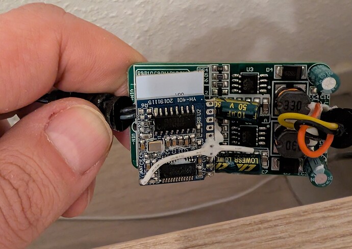

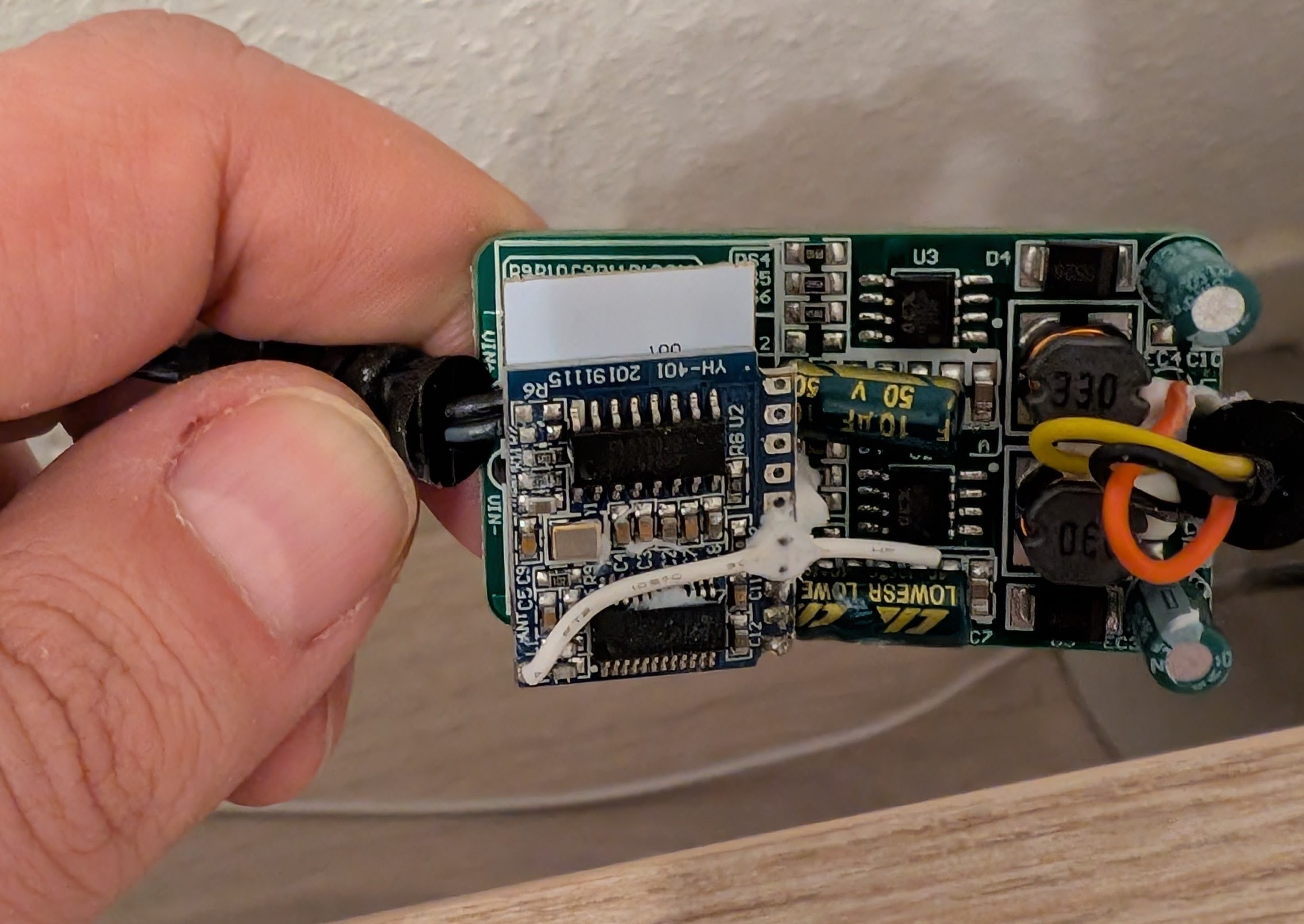

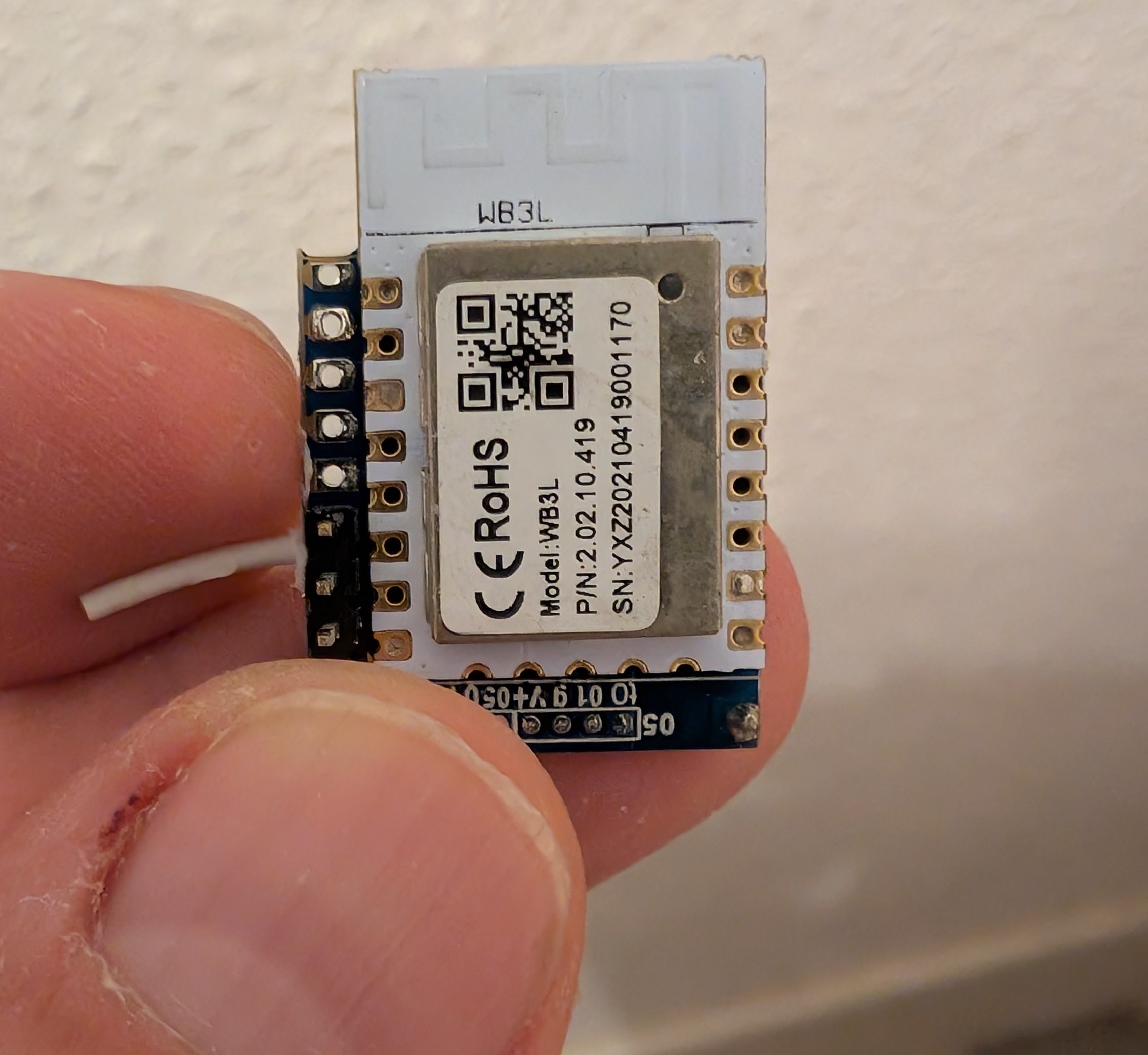

Replacing WB3L (BK7231T) with ESP8266
Yes I did it succefully. For a ligthbuld. I soldered the old one out, looked were each trace on the pcb went (that made the mapping later super easy), and soldered a flashed esp8266 in.
Just had to connect gpio15 to ground.

Yes I also just used solder to bridge the two pins.
Overall I did a really bad job at soldering, I had to use far too much heat, I just had normal solder.
I reccomend you to use low heat solder, that makes everything a lot easier.
I made a lot of error but still, everything works fine now.
