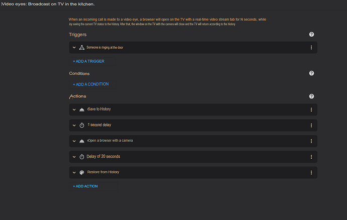

Next, we create automation that will open the browser on TV when an incoming call is made to the door. I use the “Last Notification” sensor as a trigger. Since there is no incoming call sensor in the EZVIZ integration for the EZVIZ CS-DP2C video eye, and I don’t want to disassemble and redo the video eye, I used the “Last Notification” sensor in the Home Assistant mobile application and specified only EZVIZ.

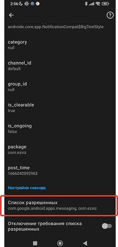

How to turn on the "Last Notification" sensor
Screenshot of automation
alias: "Video eyes: Broadcast on TV in the kitchen"
description: >-
  When an incoming call is made to a video eye, a browser will open on the TV with
  a real-time video stream tab for N seconds, while
  saving the current TV status to the history. After that, the window on the TV with the camera will close
  and TV will return by history
trigger:
  - platform: state
    entity_id:
      - sensor.tablet_sm_t580_last_notification
    to: Someone is ringing the doorbell
    alias: Someone is ringing the doorbell
condition: []
action:
  - service: scene.create
      scene_id: kitchen_tv_lg_history
      snapshot_entities: media_player.lg_tv_kitchen
    alias: Save to History
  - delay:
      hours: 0
      minutes: 0
      seconds: 1
      milliseconds: 0
    alias: 1 second delay
  - service: webostv.command
      entity_id: media_player.lg_tv_kitchen
      command: system.launcher/open
      payload:
        target: >
          http://192.168.1.50:8090/video.mjpg?oid=3&size=1920x1080&maintainAR=true&backColor=0,0,0
    alias: Open a browser with a camera
  - delay:
      hours: 0
      minutes: 0
      seconds: 20
      milliseconds: 0
    alias: Delay of 20 seconds
  - service: scene.turn_on
      entity_id: scene.kitchen_tv_lg_history
    metadata: {}
    alias: Restore from History
mode: single
