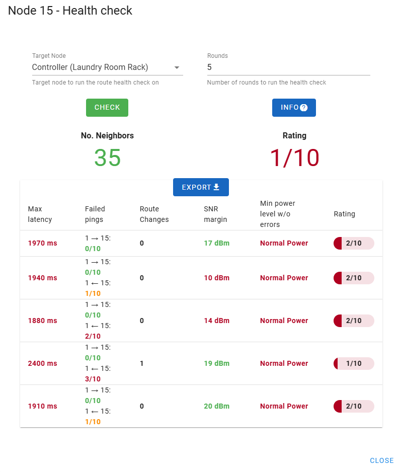

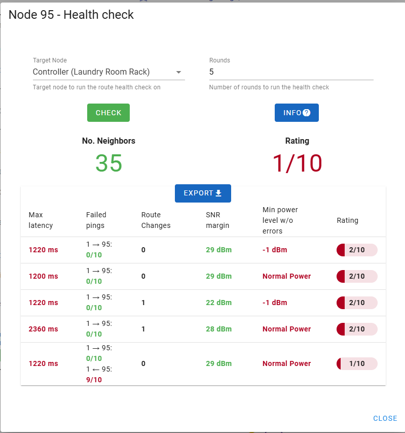

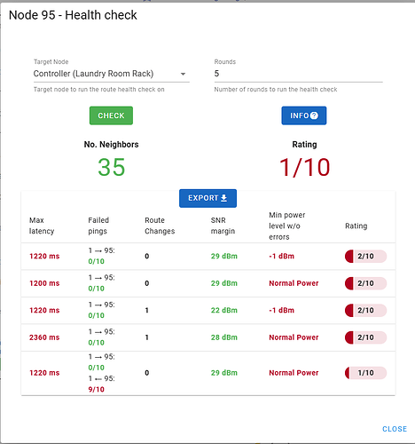

I am also finding this still has a very poor rating, but it seemingly works... Any thoughts? I find that all locks get 10/10 pings acknowledged, little failures. The old lock has higher latency for who knows what reason... All locks I have new and old, get an occasional "Dropping message with invalid payload" and they all have 1000ms+ latency, which is bizarre to me.
Old Lock:
New lock:
