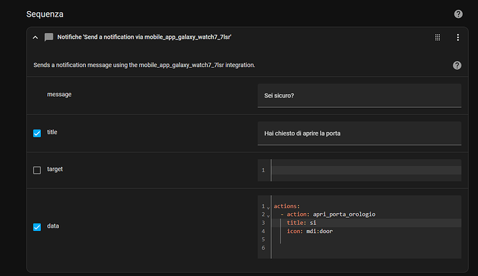

i want to use actionable notification on wear os but i receive only the notification without the “ttitle” to press
How to solve this?
They only work if they are sent to the phone that your watch is paired with.
Yes Just tried but sometimes notifications doesnt work. Coming only.on phone and sometimes in both
Try to reboot phone and watch maybe? The app is not responsible for the relaying of notifications that’s what the connected phone does.
Thx, After a reboot problema remain but i have enabled in app settings mobile data no limitation, add home Assistant to battery background apps, enabled in developer settings mobile data to Always Active.
Now seems to work fine.
