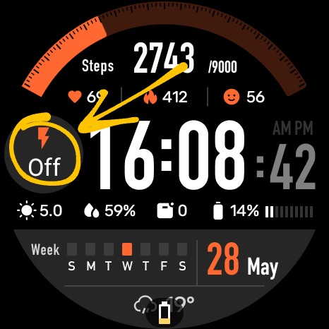

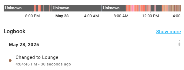

So, i think i have a workaround. HA Tile does not help, however if you use Watchface with complication and select one of the complications as HA Entity State (Like On/Off, not a Button):
then it seems to keep the main Processor active. Of course, battery life will be reduced, but at least there is an option to make HA be useful for me and active BLE Transmitter again.
Activated at 8:40, went outside twice (hance the gaps)
