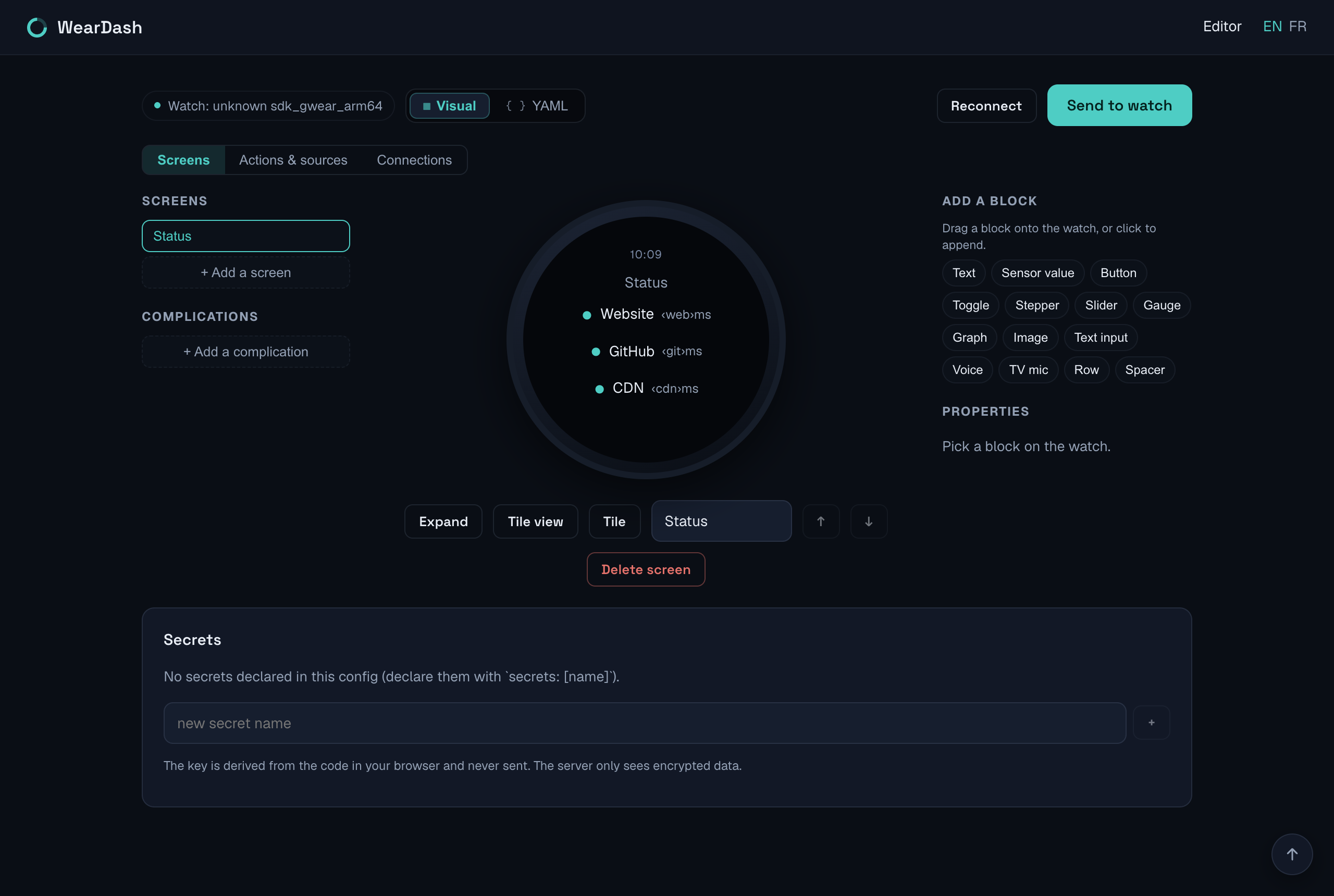

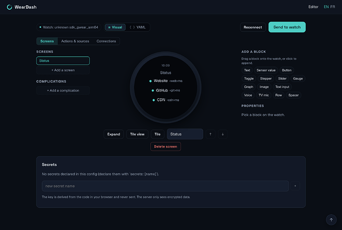

I also built a wysiwyg editor in the browser. You drag blocks onto a live watch preview, pair with a code shown on the watch, hit send. The watch keeps the config, my server stores nothing.

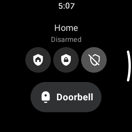

Buttons can react to state:
    type: button,
    label: "Home",
    icon: shield-home,
    action: guard_home,
    color: "{{ guard.state == 'Home' ? '#2e7d32' : '#2c2c2c' }}",

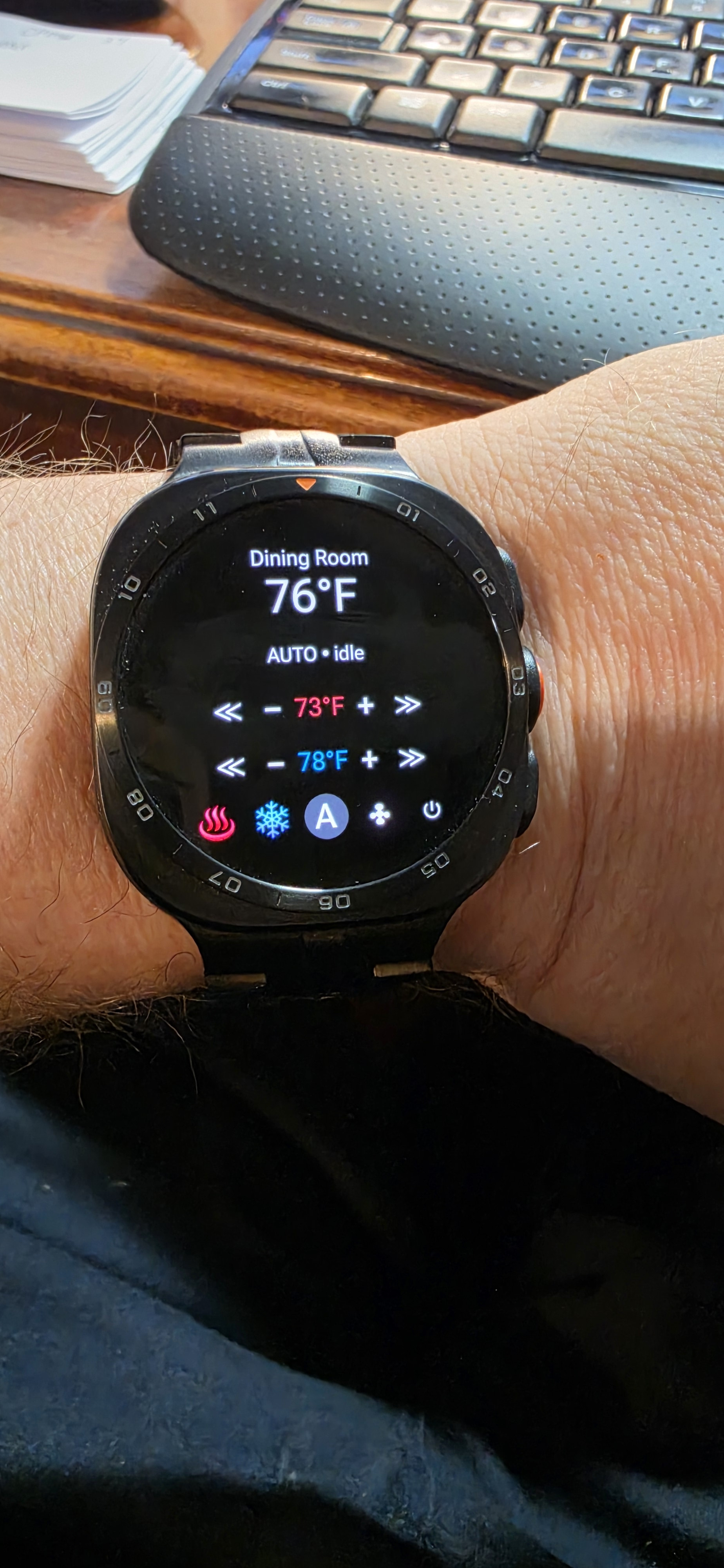

So I used WearDash and created a very slick fully functional thermostat tile - and now I am building my next (unrelated) tile now. Anyway, I thought I’d show folks the one I built (fully functional with heat, air conditioning, Auto, or just Fan, and On/Off)…

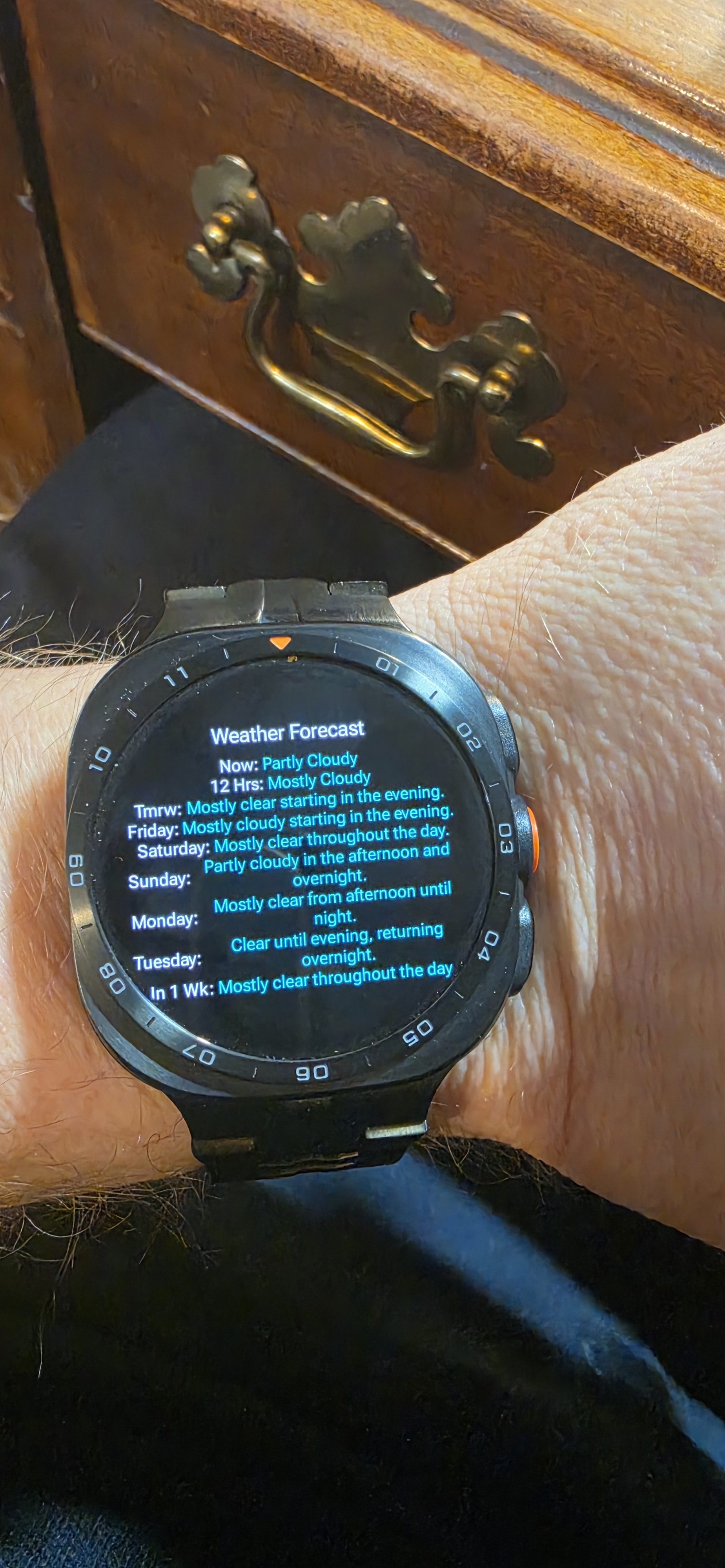

I had to come back say I just created my second one. It’s a little ugly but very useful:

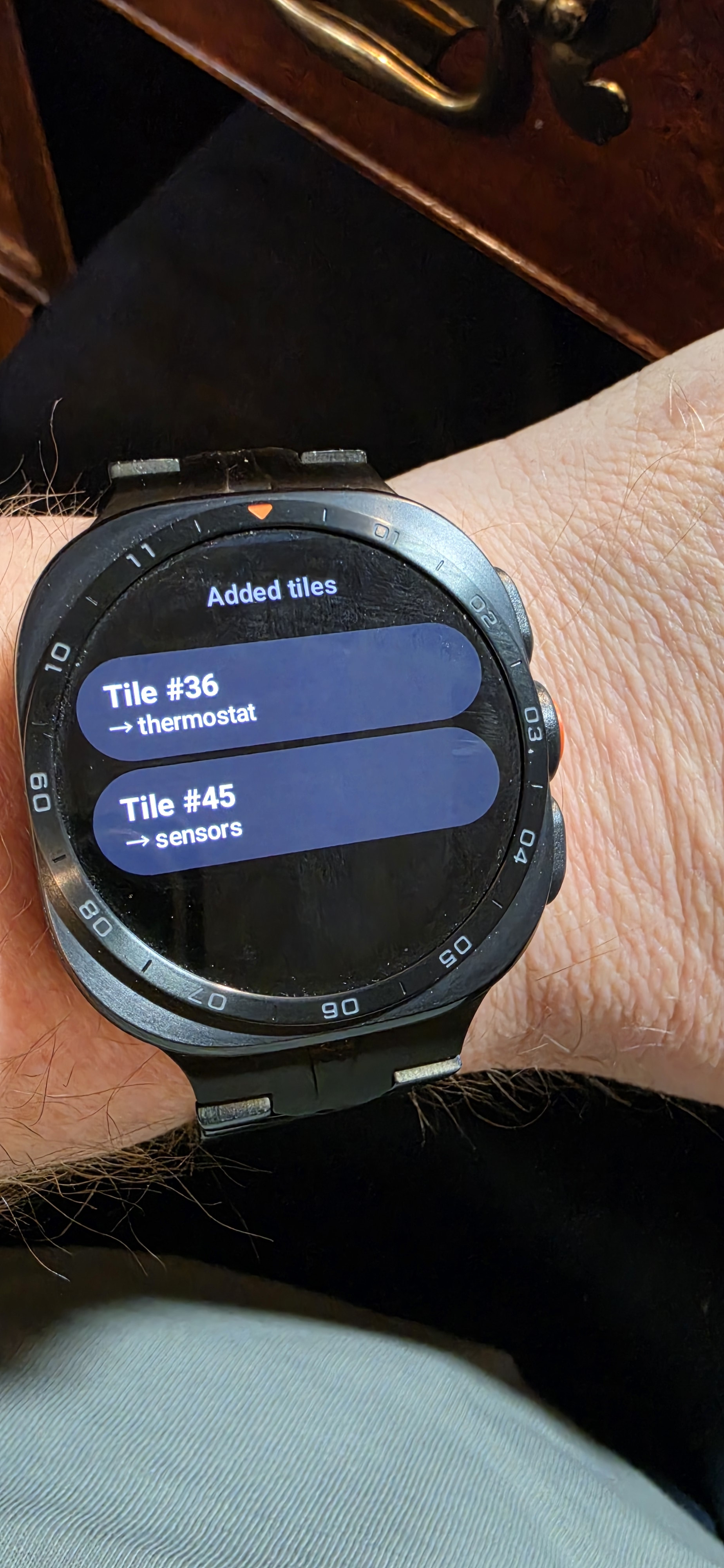

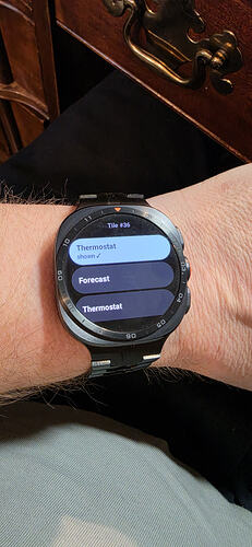

@Nand42 , Hi, thank you for all this, see my screenshots above… could you explain the intended purpose of the Added Tiles section under Settings?
I now have two WearDash Tiles added to my watch, Thermostat and Forecast, and both are working correctly. However, I’m having trouble understanding what the settings entries under Added Tiles represent.
For example, I’ve seen the same Tile name appear more than once, some entries have checkmarks and others don’t, and I’ve seen them grouped under entries such as Tile #45. The contents don’t seem to map in an obvious way to the two WearDash Tiles that I actually have added to Wear OS.
Is each Tile #xx supposed to represent a particular Wear OS Tile instance? And within that, what do the repeated Tile names and checkmark indicate?
In other words, I’m not necessarily reporting a problem. I’m mainly trying to understand what Added Tiles is intended to show and how I should interpret it.

@KruseLuds thanks a lot for the purchase, and for the screenshots. That thermostat tile is exactly the kind of thing I hoped people would build: the HA Wear OS app gives you a basic one, WearDash lets you decide what goes on it. Your “A Wear OS app” screen also gave me ideas for new UI components, in particular a curved text that follows the top edge of the round screen. I’ll add that to the list.
About “Added tiles” in Settings, you’re not missing anything, it’s just not explained anywhere. Each “Tile #45” line is one tile slot you added to the Wear OS carousel. The number comes from the system, it’s the id Wear OS gave that slot, which is why it doesn’t mean anything. The arrow after it shows which panel of your YAML that slot is currently displaying.
When you tap a slot, you get the list of everything that can go in a slot: every entry under `tiles:` plus every screen that no tile already uses. The highlighted one with “shown” is the panel this slot displays, the others are just the available choices. The same names appear under every slot because each slot lists the same catalogue, not because anything is duplicated.
If you see more slots than tiles you actually have on the watch, those are leftovers: when you remove a tile from the carousel, Wear OS doesn’t always tell the app, so the old slot stays in the list. Picking any of them does nothing harmful.
I agree it’s confusing, and I’ll clean it up: show the panel name instead of the system number and drop the slots that no longer exist. If you noticed a name appearing twice inside the same slot, tell me which one, that may be a real duplicate in the catalogue.

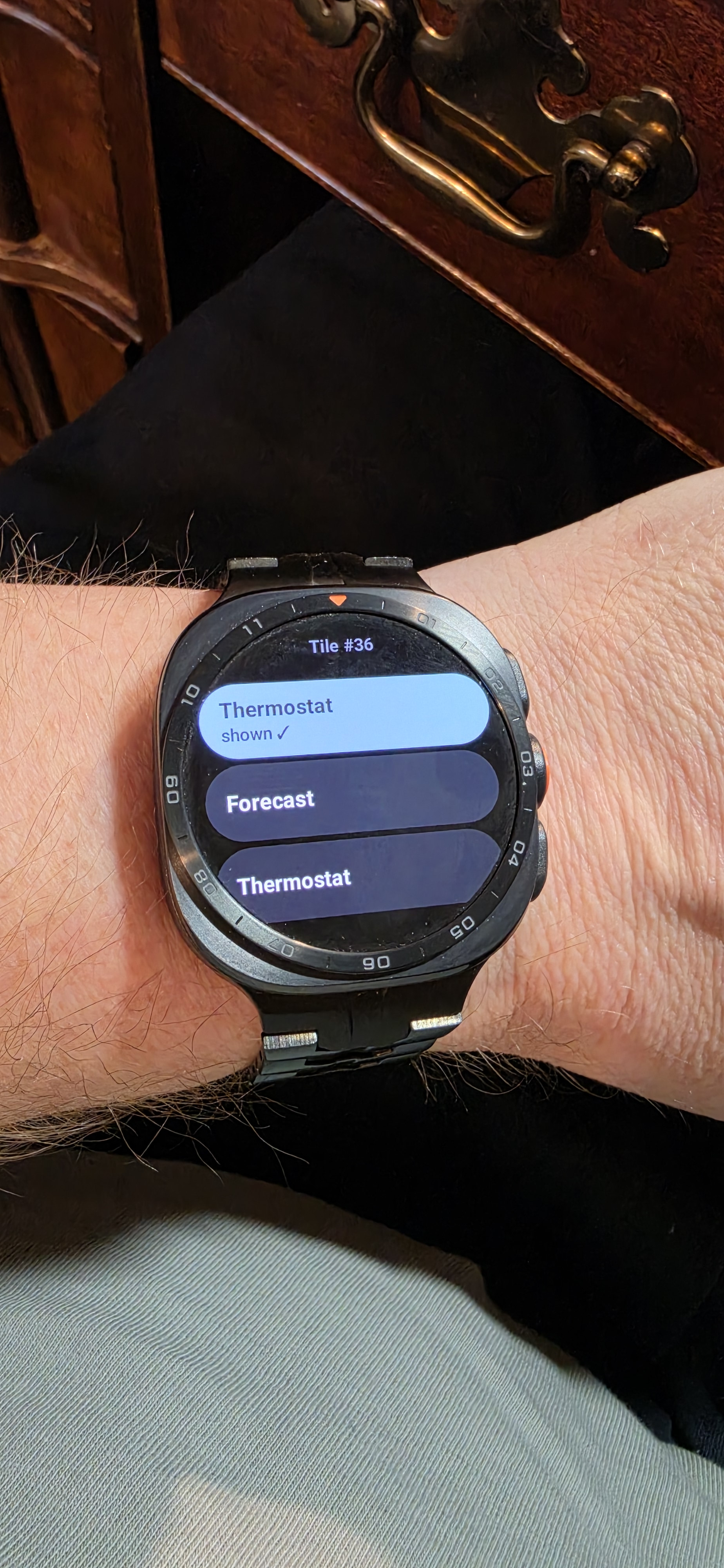

Thank you @Nand42 for your thorough answers.
There are some duplicates it appears under “Added Tiles” so here is what my watch shows. My first tile on the watch is Thermostat, the second one is Forecast (I only have two right now) :slight_smile:
Also for the thermostat for example, since the temp change message goes all the way back to the ha server and then back to the watch, there is a slight delay, but with the current implementation each press is only 1 degree, so I added the double arrows which are actually a 3 degree change. Ideally there would be sliders (can yoo make one that has two values on it which wouild be great for Auto for a thermostat?) , and I know you offer a single value horizontal slider, but with tiles sliding left and right I believe would just move you to another tile, no? I was thinking the resolution to this for my thermostat it to have vertical sliders, but you do not offer those it seems. How hard would it be to offer vertical sliders without affecting where text and buttons can be shown on each side of the sliders? And since you are making curved text - how about a curved slider, two versions, with one point on the line and with two pooints on the line. Also maybe specify the size, degrees of curvature (of course less than 360 which would be a circle) and mayb e the angle of the curvature? (That may be overkill lol!) Maybe the curve could be around the outer edge of the watch and all the text and other buttons inside it :slight_smile:
