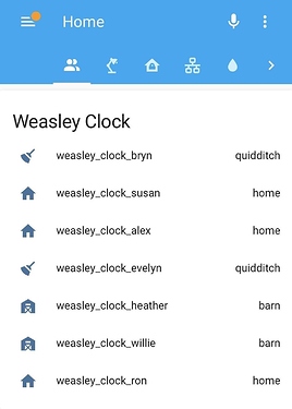

This isn’t a 100% Home Assistant project, but I did use Home Assistant as an integral part of this project. I built a Weasley Clock like the one in Harry Potter that uses hands on a dial to display the location of my family members.
I use the Life360 integration for location and speed data, the unifi integration to track which wifi AP people are attached to, and the HACS Zwift integration to know when people were using Zwift (VR indoor bicycle riding). From that data I determine each person’s location/state and update a sensor. When someone’s Weasley Clock state changes I publish a MQTT event that the physical clock controlled by a raspberry pi and my own custom python code. The Pi then controls some servos that move the hands to the corresponding sector on the clock. When the Pi comes online (boots or the server restarts) it sends an update request to Home Assistant that then publishes all the family member states.
