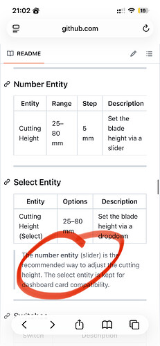

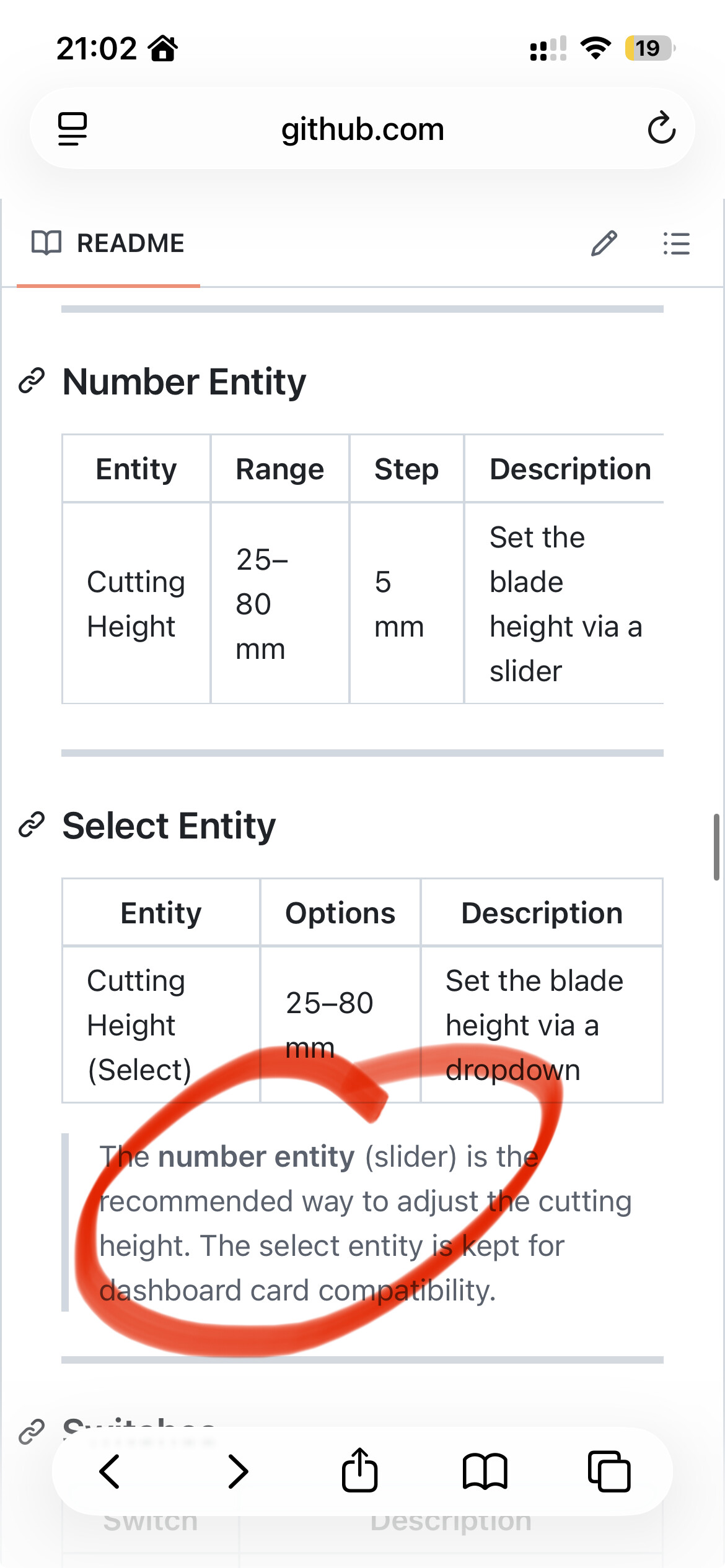

Cutting parameters are mentionned with a notion of slider or a dropdown list to choose.

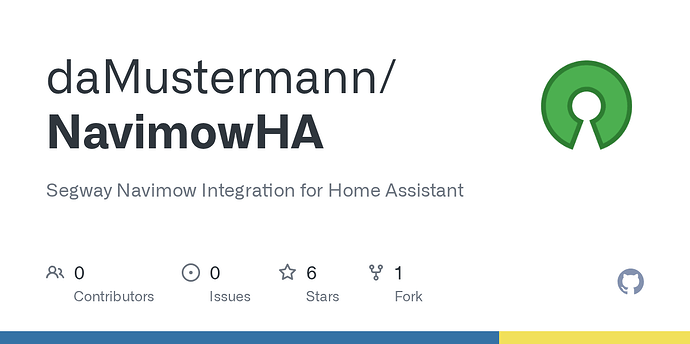

Thanks for the daMustermann/NavimowHA pointer. I installed it to try actually setting the height. On my X450:
Install and OAuth login: fine. Live status works well (battery, mowing/docked, start/pause/dock).
Cutting height: it adds a number entity (25 to 80mm) and a select, but both read "unknown", so no read-back of the current height.
Setting it: the integration logs "Set cutting height to 75 mm" and publishes the MQTT command with no error, but the Navimow app's Global cutting height stays at 80mm. I tried it while mowing and again while docked, force-closing and reopening the app each time. No change.
I also checked pgoutsos/NavimowHA and it doesn't expose cutting height at all, just position/zone sensors.
So on the X450 the command goes out but nothing happens. Has anyone got cutting-height setting actually working on an X-series (X4 / X450)? Or know whether the command differs from the i-series? Happy to grab debug logs or test things.

Édit : did you see that ?
Thanks - yes, that's the one I used: the number entity (via a slider): number.gary_cutting_height
