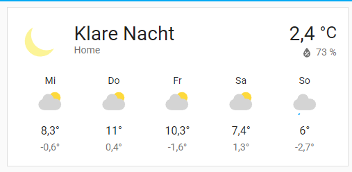

grafik
So I think, the FR is still valid - the default Weather.Forecast should somehow be able to provide the information if it is night.

in addition, I just found how to add the forecast option to the accuweather integration.
So this is solved for now… (now let’s see, if the issue of the met-integration is currently a bug or not)
Didn’t recognize, that I have to enable the forecast option seperately

as already mentioned, just found how to enable forecast on accuweather :slight_smile:
grafik
It is interesting, because the forecast (and temp. information) between accuweather and met are slightly different… so let’s see, which one provides better information in the end :slight_smile:
