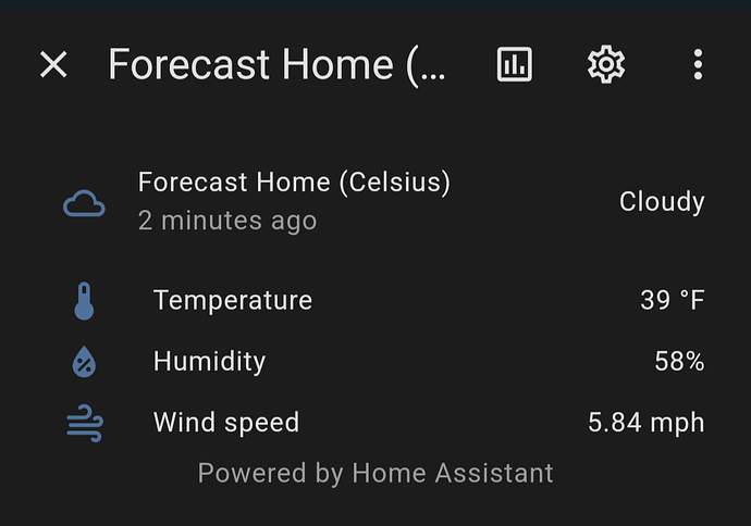

I am looking to make a custom weather Entity via the Weather Template so that i can have two weather cards from the same weather integration, one with Celsius and the other in Fahrenheit. I am using the Meteorologisk institutt (Met.no) integration. I started off by configuring a second entity from this integration and changing the temperature units to C and i got the following:
The numbers are correct in that they have been converted to C but the unit still showing F.
I figured the next step was to use the Weather Template to create my own entity. However, my code:

results in:
The result is back in F and I don’t have the hourly forecast.
I think that I need to use weather.get_forcasts to get the hourly forecast but I am unsure how to make the connection.
