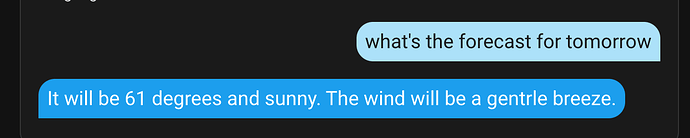

You need to say what's the weather forecast for tomorrow
I guess I could allow what's the forecast for tomorrow as well. You add or change the trigger sentences in the blueprint
Change weather [forecast] in the trigger sentences to (weather [forecast]|forecast)
Hmmm…same response, unfortunately.
The weather entity I’m using is exposed to Assist. Does this still require the met.no or can it use other weather integrations? Thanks
It needs to be what'sor what is
whats is not recognized in the trigger sentences
There is no full task support. Date and time cannot be added to the list
Apologies. I finally got it to work. Thanks!
Changes the sentences as described worked. Thanks!
There’s a small typo in the response. ā€œGentrleā€
Thanks, this has fixed the issue for me.
