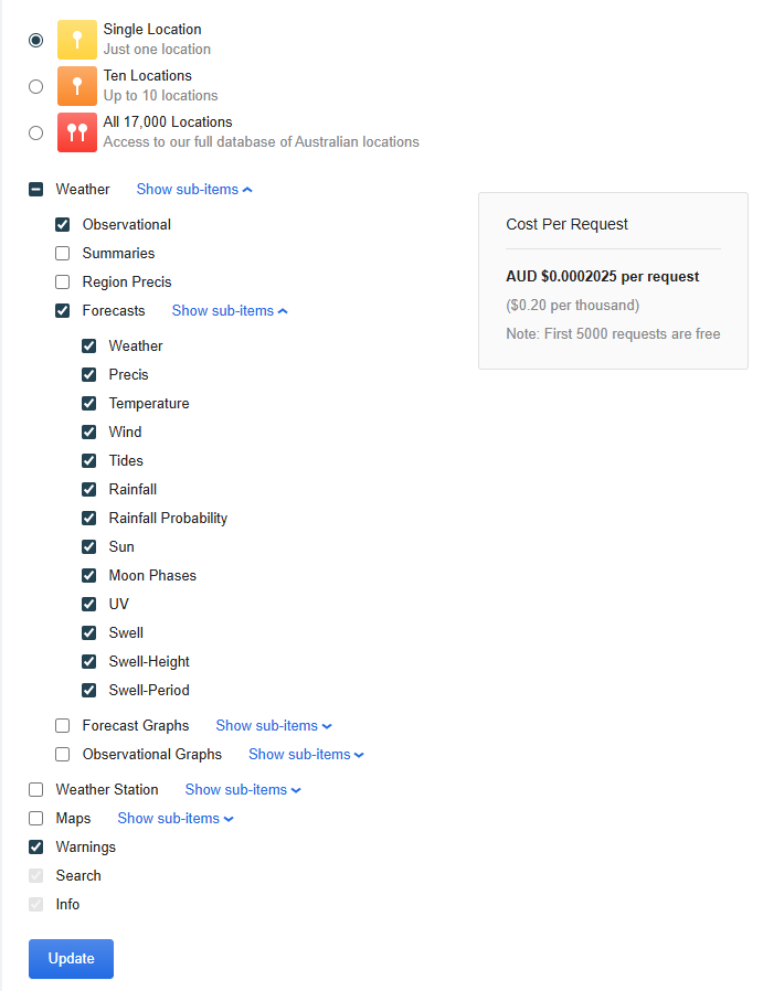

Just set it up as per the screen shots in the doco for the integration.
yeah doco on the site is crap… will have to bin this idea then
I’m not sure what the problem is here.
Your screen shot of your Willy Weather API configuration above is quite clearly different on a number of options from the one I provided in the readme:
Yours has:
  • 10 locations when it should be 1
  • Nothing under “Weather”. You have options under “Weather Station” (and then under “Observational Graphs”
You need to set the options under “Weather”, then “Observational” and Forecasts.
Just look at your screen shot vs the one in the link above.

You just have to make sure that the API key is correct in HA and that the right tick boxes are in WillyWeather API config as per the screen shots.
If in doubt, tick them all, then gradually remove them until it works or you break it!

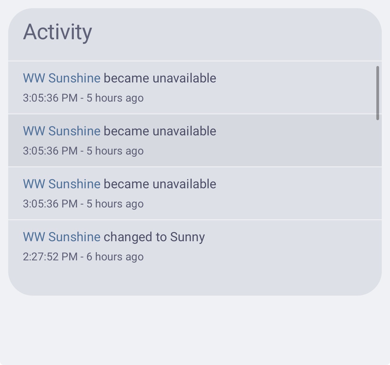

Also looks like it pulled the data initially then went unavailable. Screenshot
Additionally. the sensor doesn’t seem to update the night time forecast. It’s remained “Sunny,” even thought it is well past 10pm. Note I initially set my nightime as hour 23. BoM and Met are both showing Night, Clear.
This error is fixed. Home Assistant deprecated a config_flow process in 2025.12
The unavailable error I can’t fix without detailed logs or more information.
Please submit proper bug requests with all details.
However, the clear-night thing is a WillyWeather API response. It does nor provide a distinction between day and night.
I have updated the code to map sunny to clear-night when it is nighttime.
