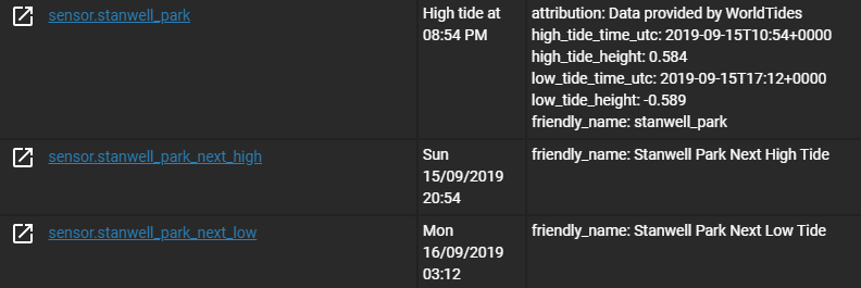

ok, so i set that up and it just the time of the next high tide. Is that all we get into HA ?
- platform: worldtidesinfo
  api_key: abc
  # latitude: !secret latitude_loc_home
  # longitude: !secret longitude_loc_home
- platform: template
  sensors:
    stanwell_park_next_high:
      value_template: '{{ as_timestamp(states.sensor.stanwell_park.attributes.high_tide_time_utc) | timestamp_custom("%a %d/%m/%Y %H:%M") }}'
      friendly_name: "Stanwell Park Next High Tide"
    stanwell_park_next_low:
      value_template: '{{ as_timestamp(states.sensor.stanwell_park.attributes.low_tide_time_utc) | timestamp_custom("%a %d/%m/%Y %H:%M") }}'
      friendly_name: "Stanwell Park Next Low Tide"
