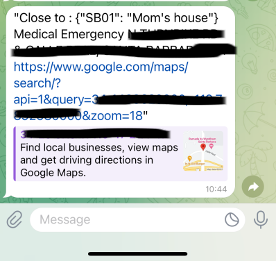

You may be well beyond this and I’m not addressing your weather content in Telegram message. That said the automation code below that I have been using to send a Google map link via Telegram has been working solid for a number of years, might give you some ideas. Good hunting!
- service: notify.DEEP
message: '"Close to : {{ state_attr(''sensor.pulsepoint_sbco'', ''key_location'')
}} {{ state_attr(''sensor.pulsepoint_sbco'', ''desc_short'') }} {{ state_attr(''sensor.pulsepoint_sbco'',
''address'') }} https://www.google.com/maps/search/?api=1&query={{ state_attr(''sensor.pulsepoint_sbco'',
''latitude'') }},{{ state_attr(''sensor.pulsepoint_sbco'', ''longitude'')
}}&zoom=18"
