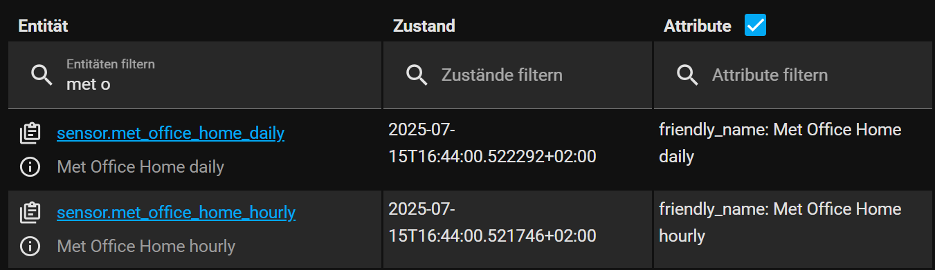

I can see a timestamp now, but no data:

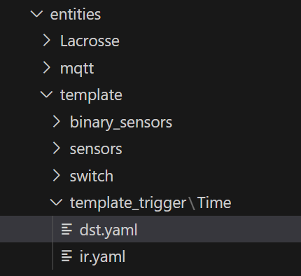

I have included templates like this:
configuration.yaml:
packages: !include_dir_named integrations
Folder integrations:
template_trigger.yaml
template: !include_dir_list ../entities/template/template_trigger
it works always, once I have tested it in the configuration.yalm, I move it into the respective folder In this case it is:
and there is also annother template_trigger (I found it now :slight_smile:
it works.
I can remove the “include” of the template_trigger-folder but I do not think, that this is the issue!
