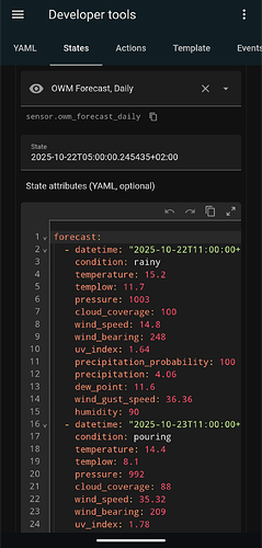

Here ist the most compact but still complete YAML code I could come up with.
It creates a weather template entity which is based on OpenWeatherMap including its forecasts, but uses my own sensors for temperature, humidity and dewpoint.
template:
  - trigger:

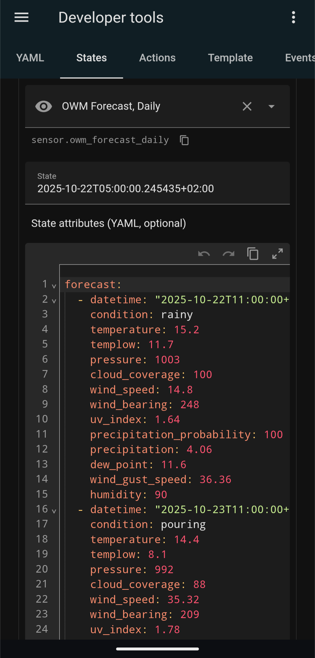

For me it is still not working. Can you show what you get under “OWM Forecast, Daily” entity?
I do see supported_features: 3 for the newly created entty but when I open it I get no forecast. My current code is:
