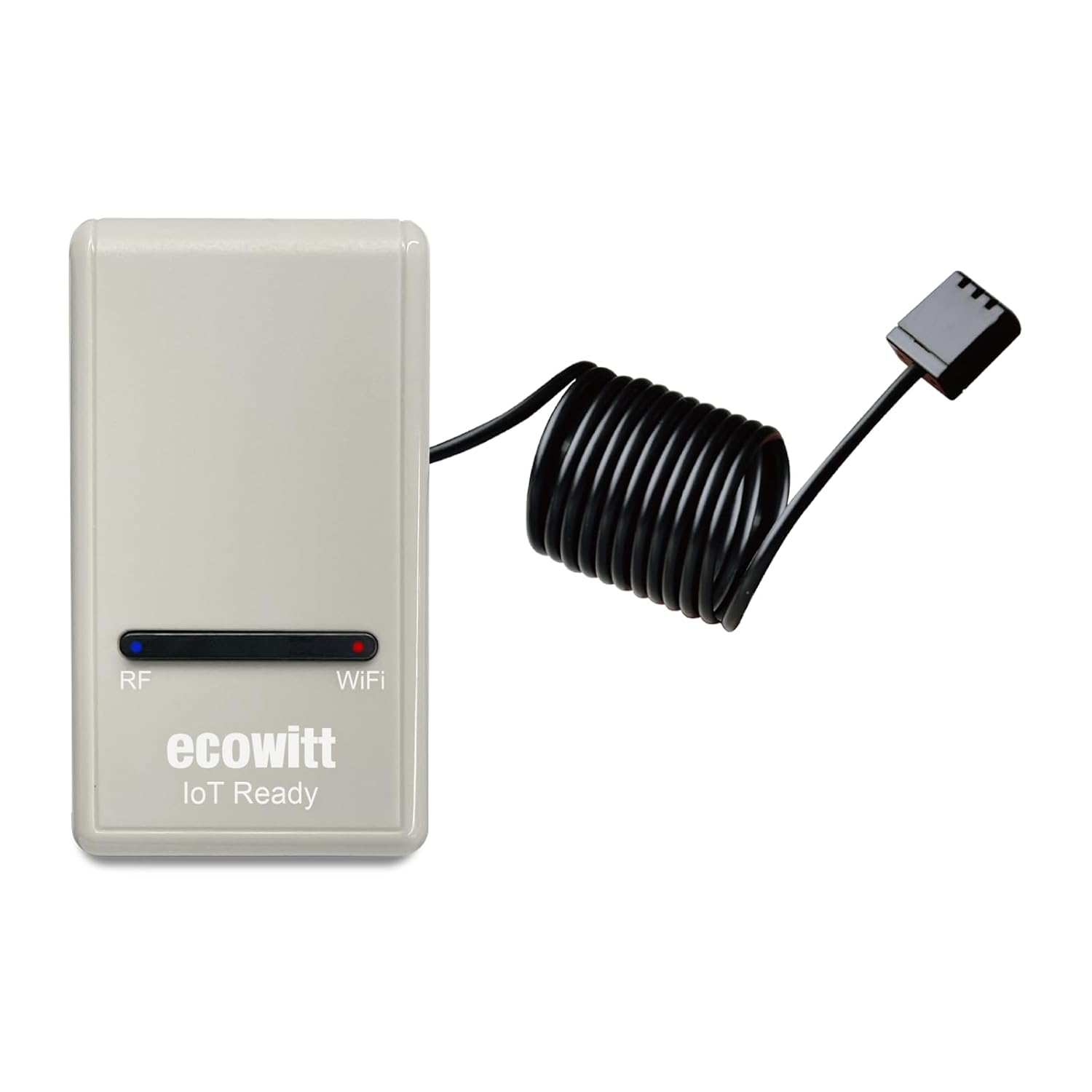

I have an m5 wifi version and use now an ECOWITT Gateway GW1200 so i can upload the data to Ecowitt (and dual mine with fry network
