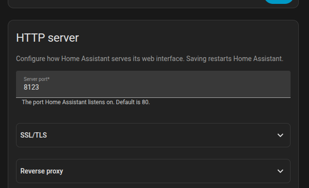

Have you tried to remove the port in the url ?
With the new release the port have changed to the regular one, so you don’t need to add this magic number (8123) any more

I think when you upgrade and not reset, the port stays like before. you can change it if you want.
