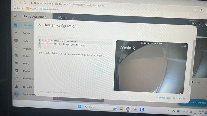

Hi, i have a reolink doorbell and want to stream it via Dash Cast and the WebRTC integration to my nest hub because of the better latency than the reolink own one. So i created an automation and the new entity and it works Fine on my dashboard. But if the stream should start on the nest hub, i only can Rest „DashCast“ in big latters and doesnt see the cam… any ideas?
Hi, just configured it. you need to mark the “force restart”
Thanks now it works… but how can i end the streaming automaticlly After 30 seconds? And is there a way to volume up the Bell Sound?
