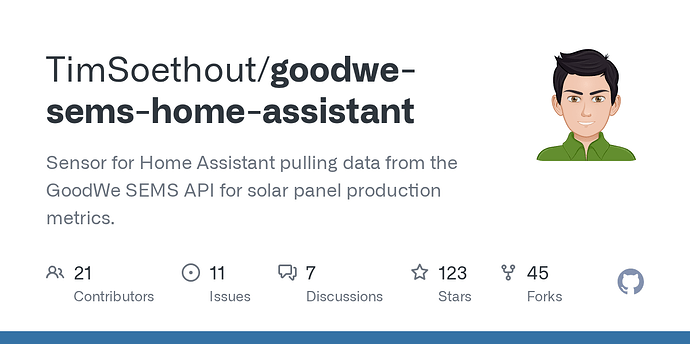

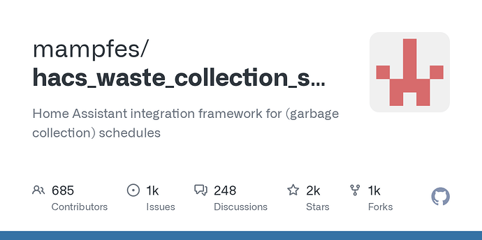

Two active HomeAssistant web scraping integrations that spring to mind are the HACS integrations for a SEMS Portal, and the Waste Collection scheduler. Have a look at their code for ideas.
