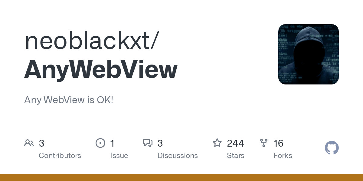

Anywebview:

Install Anywebview, from your USB stick
Go to the Xposed app and enable the “any webview module”.
You need to reboot to make it effective.
