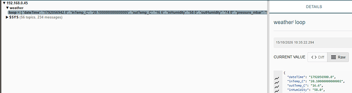

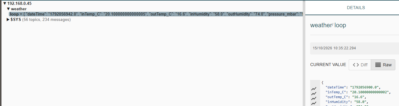

I have configured MQTT in HA, as well as MQTT explorer, and I can see the data coming in

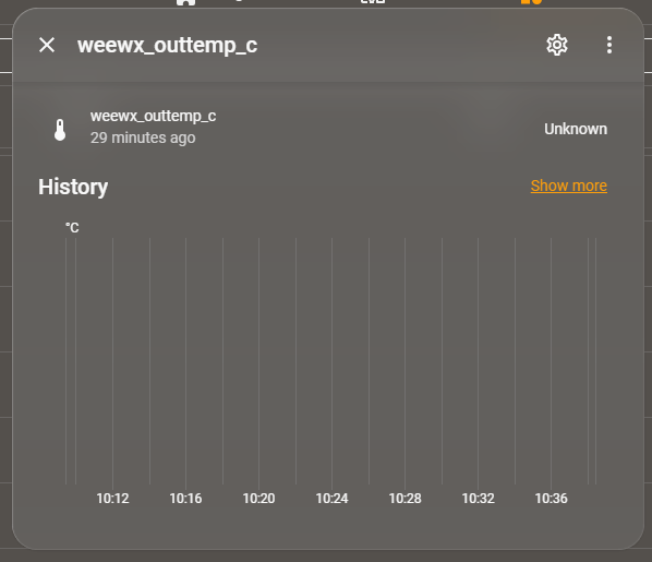

I can see that device as an entity under MQTT
I’m not getting any data into that device though. I’m sure I am missing some simple link, but I don’t know what. Any pointers would be more than welcome.
